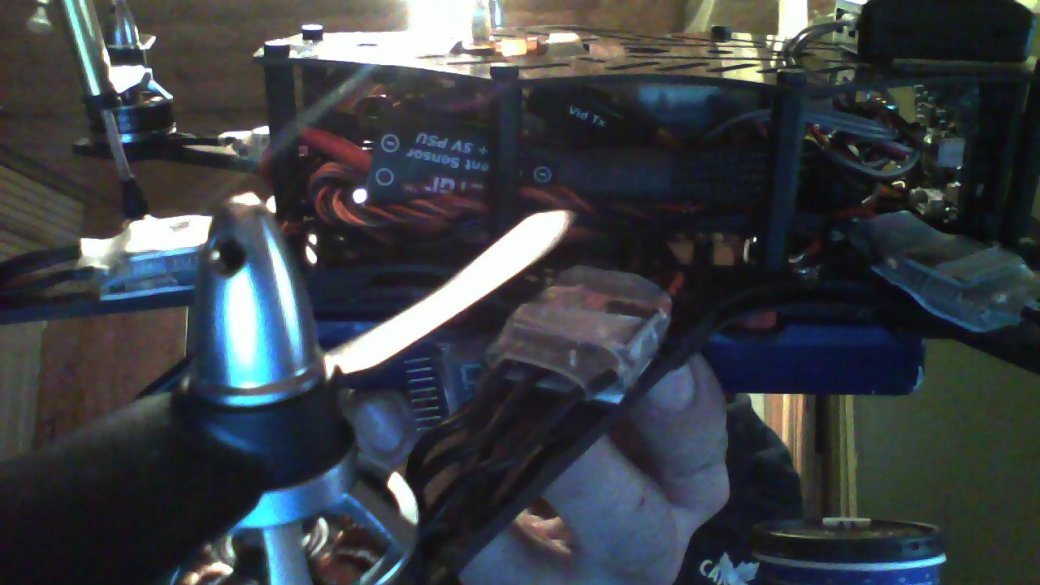

Congrats to @RunnerDuck! In my short time here at multirotorforums this is the fourth time I've seen a thread where the majority of posters were screaming, "check you motor rotation and/or your wiring... you've got something reversed!"
I realize it can be super frustrating but that "ah ha!" moment is just as equally satisfying. Oh yeah, I can relate with the age thing as well (I'm 50-ish). Besides memory issues I have a hell of a time doing close up solder work due to poor up close vision, even when I put my reading glasses on.:(
Thanks Gary I appreciate the comments.
The sad thing is I'm so diligent at labeling things so I don't make mistakes. I just never thought I could have labeled the connectors wrong. I'm 70 but still...
