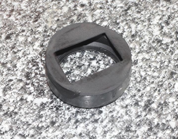

I tested the new H firmware and It was great. I also tested out an idea to stop flicker from Blade shadows that hit the front of the lens when shooting towards the sun. The idea is to keep incident light from entering the side of the lens at the front element. This simple device was made from a wide angle hood that was shortened and a baffle plate added. It works very well. I also modified the Zen by moving the IMU bracket to the end of the rail so that I can reach the Nex-7 switch. While I was at it I put a small spirit level on the top so that I can check my horizon before take off. That is for when I don't have a monitor and shooting alone. It did of course need rebalancing. The latest Zenmuse firmware seems to have dealt with a drift issue on the roll when flying with the camera locked to the models heading. View attachment 9524
