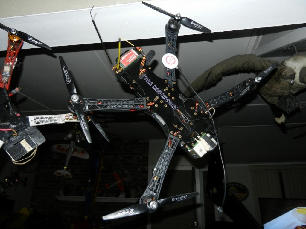

Quick question off topic. I have a Discovery frame ordered with the Core pre soldered. It should be here in a week or so. How do you have your GPS mounted on your Discovery?
that's what i'm asking for,,,,,,,, mine is coming too. can't wait to have it right
I'll fly it tomorrow and see how it works there

I know that the UHF receiver is on the back but I would try between the D and the S on the top plate. That would make a really clean install, especially if you painted the GPS black. Very stealthy. I won't be using UHF since I am fine with less that 2k performance.
earlier i had it between the s and c in discovery but on the pole. i was kinda worried about the video gear but will give it a try on the floor there. i'm down with keepin it clean

Cool, keep me informed. I really want to transfer my FPV gear from my F450 to the Discovery and keep it as uncluttered as possible. My friend who is a pro wants something that can be transportable and versatile. The Discovery may be the solution to his requirements. I wonder if a Nex5N would work? I may have to try one.
that was a good call. i think next i'll try straight in front of the front of the battery bolts, looks will sit with a mounting of x=0 y=0 z=3,,,,,,,,

put a black wrapper over the ezuhf too. All that's left is get this moved to the good frame, get the real cam mounted and working and loom all the wires. everythings lengths have already been changed, after the gps works i'll trim that one down.

flew a few packs and the sat where it's mounted is perfect. next i'll power up the eagle tree and see what that does to the mix

flew this thing today with everything on and walla, kept loosing gps signal on the naza in flight. Eagle tree never waivered,,,,,,,,, so gonna spread em apart a little bit. I also changed the video tx from that 800mw 1.3 to 300mw 1.3 to kill the interference issue. Strange, other cat was helping here was having the same thing happen. only 2 things the same is the video transmitter and naza gps

Kloner, my Eagle Tree GPS and Naza GPS are separated by 19.5cm on opposite arms. I have never lost Naza GPS with that separation. I am using a 5.8gHz vTx at 500ma with the antenna pointing down. I don't know how that fits into the mix.
got it locking in inside the house now....... think a few things played in there. it was painted....... i was running a 800mw vtx on a really small area with uhf and another sattelite.
The only spot i can get it to not make interferrence is all the way out back on top of the uhf rx. had to move the antenna forward, shorten its cable. this antenna id 11cm across. i'm getting about 18cm gap between vid tx and naza sat. the eagle tree sat doesn't give a crap. it just locks in and works wherever
