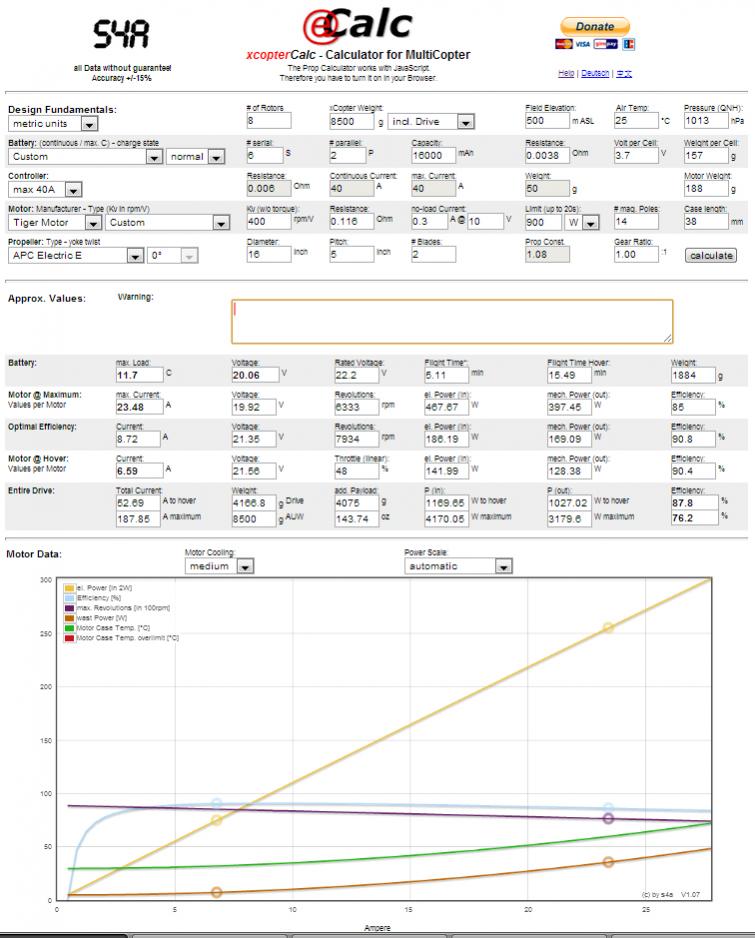

I'm trying to decide between the 4014 kv400 motors and the 3515-15 kv400 motors. I have seen people posting comments saying the new 40xx series motors should be more efficient.
I'm building a Skyjib X8 to run on 6s and 15 or 16 x5 props, AV200 and up to 5d camera. Have put the calcs in ecalc and it says the 3515 is more efficient and gives longer flight times.
Anyone tried these motors or have any thoughts?
Craig
MN4014 kv400
MT3515-15 kv400
Bigrock
I use 6 of the 4012 340kv motors and they seem like some good motors but time will tell.
Where did you find the specs needed for ecalc for the the new 40xx series motors?
