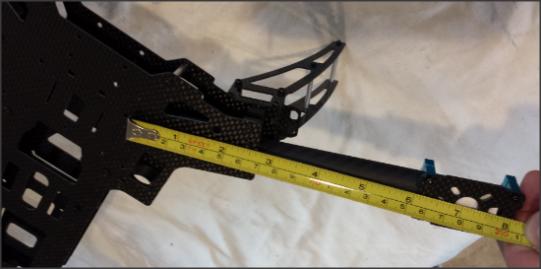

Almost as soon as I bought the 14" props I realized that I had a conflict. It seems that my frame isn't really set up for props that big. I will have to remove the gimbal rails (the gimbal I got doesnt seem to have clips to make use of them anyway), and it seems like the props will sweep over a bit more of the frame than is probably a good idea. Attached are pictures of where the 7" radius will end up.
View attachment 17062View attachment 17063

I took the word "suggested" literally. So what's the worse that can happen? They will physically it onto it. I suppose the washing-over the frame will cause vibration/instability/something else? If the problem is "too much", I can always get another frame and install the whole works into it. Or, as I have not ordered the motors yet, I can get 12x6 props and Sunnysky X4110s-20 400kv motors for these numbers:

but I note that even though 12" props will clear the rails, they also wash over the frame a bit.

I would imagine that the prop being over the frame could cause some turbulence and make the prop not work to full capacity/efficiency. But I have no experience with that. The worst case is it snips some wire up there.

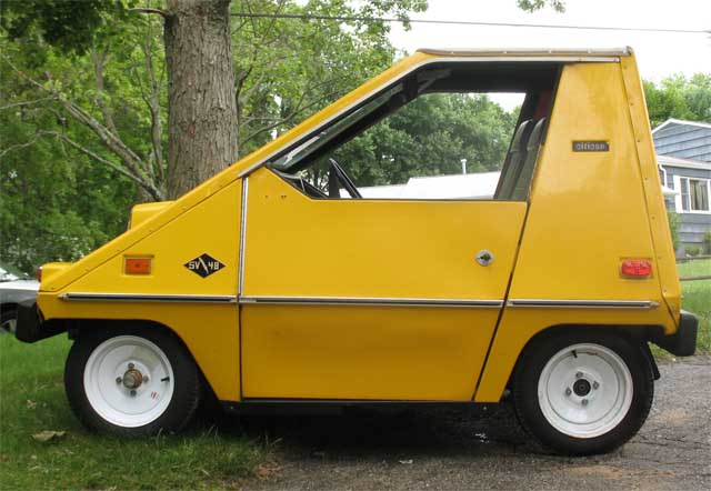

By the way if you are wondering why some nutcase is starting out in the hobby with a "big" project like this one, the answer is that I sold one electric vehicle (see pic) in favor of another. The dough I got will just ABOUT finance this production.
This one (1975 Citicar) was almost as DIY as a quad, and parts are much harder to find.

That thing is neat!
