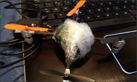

Just got the Ladybird QR. Works great. Me, I am not so sure about. This is gonna take a bit of time. After thrashing about inside for a few minutes, I winterized the quad (see picture) to protect it against the snow and headed out. Didn't take me too long to find a nice place to hang it about 20 feet up. It's back on the charger now, "safe" inside.

It's all part of the learning curve. I am not ashamed to admit to using my Browning BPS 12G shotgun and 2 deer slugs to retrieve a wayward and tree entangled "toygrade". I shot it down, retrieved it, put a new battery in it, and it resumed flying like nothing had happened. There is a pine tree now called "Shorty" among the other pine trees. Trees avoid all my quads now. Vicarious learning. I can do this legally where I live. I am truly fortunate and I realize this.
