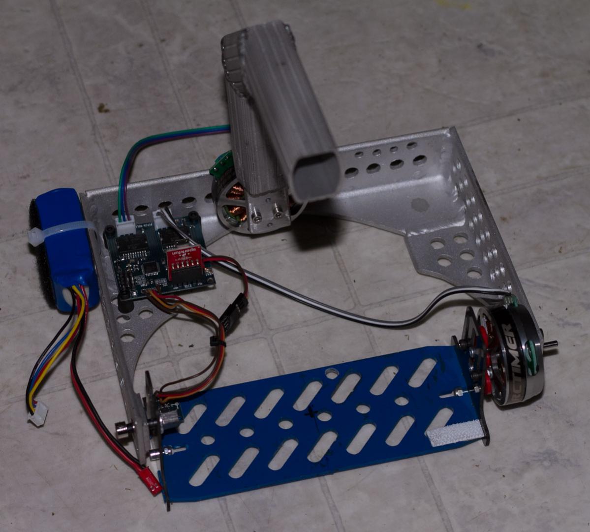

My brushless gimbal result
I am having trouble with my controller board. I updated it to 2.0 and now it won't connect to "COM5". I reinstalled the FTDI driver and tried it several different ways. Nothing works. The controller is still working and I did get it to come up on GUI 1.3 once but now when I run the 1.3 GUI application it just does nothing. I've restarted the puter multiple times and tried all I can think of. Anyone have any idea what I'm doing wrong? Win7 x64. Firmware is still 1.3 on the board, just can't talk to it to change it.
I got it worked out. Had to start over with 1.3 on another older laptop running Win7 x32. I upgraded to 2.04 using that laptop and now my x64 laptop is back up and running. I got the gimbal dialed in, now I need to find a nex5n to stick on it.
