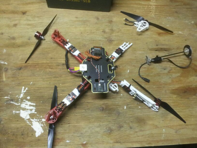

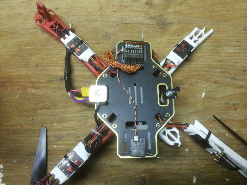

Carnage.... The rx is bottom mounted aswell as the sat as u can see, i "thought" them being on the bottom wood be good considering it is normally up in the air

The active antenna on the sat should hang past the carbon fiber to prevent reflection, actually. Are you running the telemetry? I don't use Spectrum except for my heli's, but I know there is a certain sequence to bind that makes it all work together. It's a pretty recient post, too.

I'll bet the placement of the rx and sat had something to do with this.
mutley, got any pictures of your setup

You can get a clean 2200 feet out of the system you got there now, just gotta move that sat up onto an arm pointing the little wires up and down
I put a tslrs rx in it, ill do my best to figure out antenna layout as they are both about 16 inches long, id use my spektrum gear again and i will be when i finish my AD-6 which is the tslrs's home but i just read allover that spektrum doesnt do well with objects blocking line of sight, ill give this ago and see whats what before i put 4000 bux in the air for some photography lol. For clarification tho, i should have my spektrum SAT in a vertical fashion on an arm? sounds good
