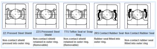

Incidentally, here's a good page on the Boca site "all about bearings" :)...
http://www.bocabearings.com/dropin.aspx?f=bearing-engineering-guide.txt
Here's the bit about the different shield types:
