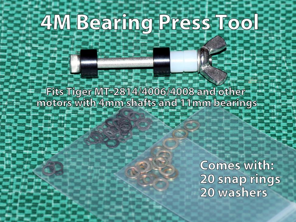

I've had a few prototypes of this tool made and they've been used successfully by myself and others. An order is expected to arrive on or before Nov. 2 at which time I'll begin shipping orders.
This tool is for the Tiger 2814, 3506, 4006, 4008 models of motors but will fit any motor with 11mm OD by 4mm ID bearings.

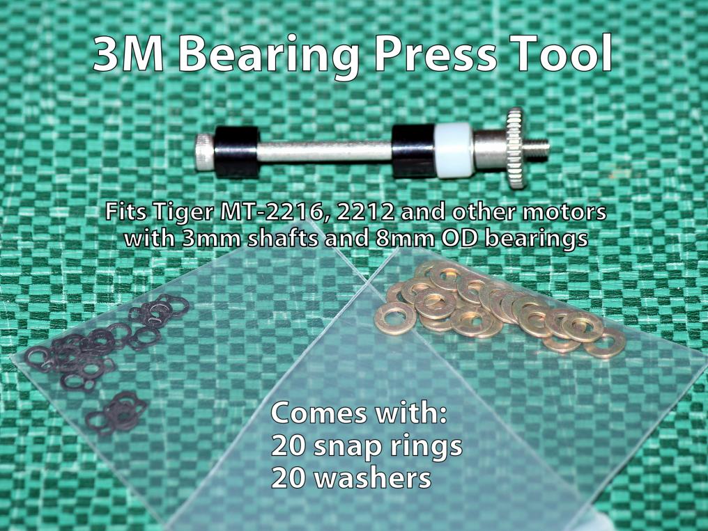

There is also a smaller version of this tool available for Tiger 2216 and 2212 motors and DJI F450/550 stock motors which use the smaller bearings.
See the video demonstrating how to use the tool, HERE
Discussion thread, HERE
Included with the tool will be 20 replacement snap rings and 20 replacement washers.
Black anodized aluminum press blocks and stainless steel hardware.
3mm or 4mm ID tool pricing (revised):
$26.50 shipped in the US
$30.50 shipped international
Please make payment via paypal to barchiola@gmail.com and that will also serve as your order. If I have any questions about your order I'll email you at the address associated with your paypal address.

nice set Bart.... love how the extra parts your gonna loose and destroy even come with it. There is nothing more important changing bearings than handling the new ones right and this foolproofs it
Thanks Kloner. For such a simple little tool, a lot of thought has gone into it. The nylon spacers are for pressing bearings into the flatter (aka "pancake") motors.

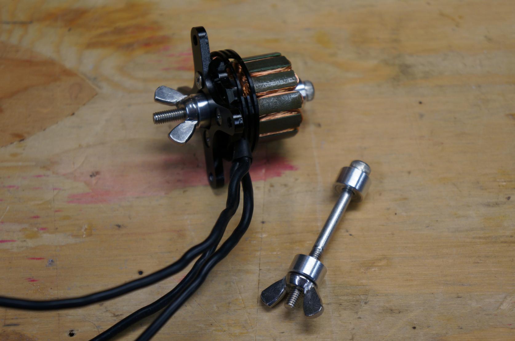

Thanks for the order Andy. Here's the video I made showing how it's done.
http://www.youtube.com/watch?v=z4NvWqkvx3k
Just make sure the recessed side of the press blocks face in towards the motor. The recesses prevent any force from being applied to the inner race of the bearing.
