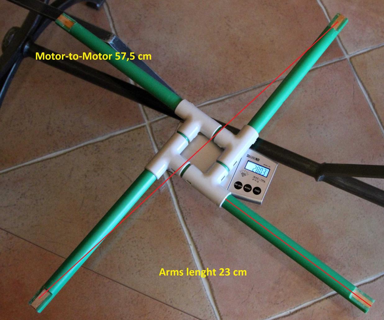

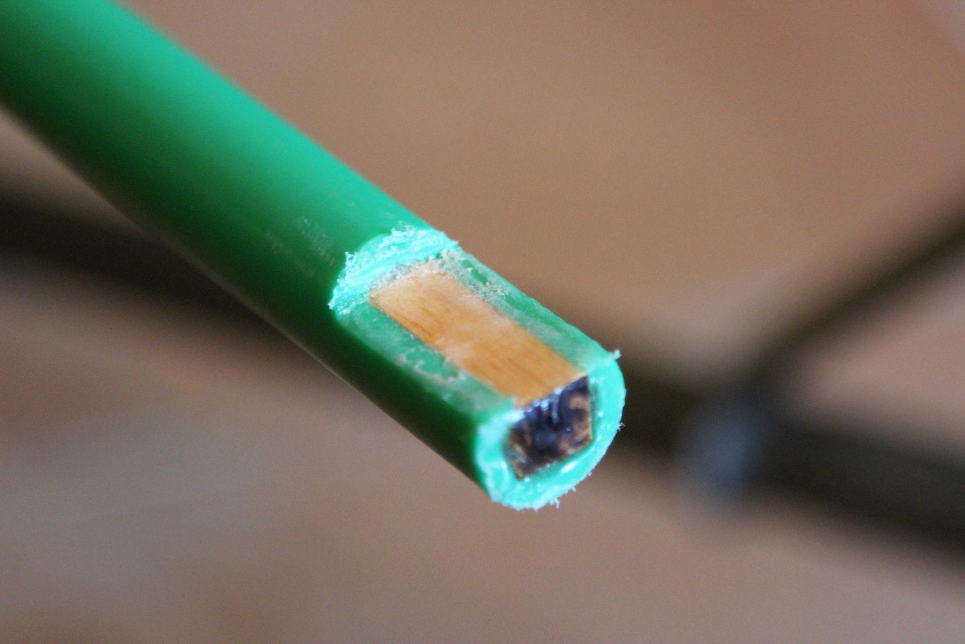

I am building a pvc t-quad, arms are a bit too long (23 cm - motor-to-motor 57,5 cm - 280,3 gr) so I have to cut them, what do you think about this idea for motor mount ?
View attachment 6771View attachment 6772
That looks pretty cool. Did you make those arms with the wooden core?
Yes Matt, a piece of wood 6 cm (1cm x 1cm) long is inserted in the pipe and the top part of the pipe is removed (3 cm).
Based on your experience, I have seen that sometime you have used arms 17 cm long or 20 cm long my arms are 23 cm long, do you suggest to cut them ?!
how does the copter behavior change testing different arms lenght ?
