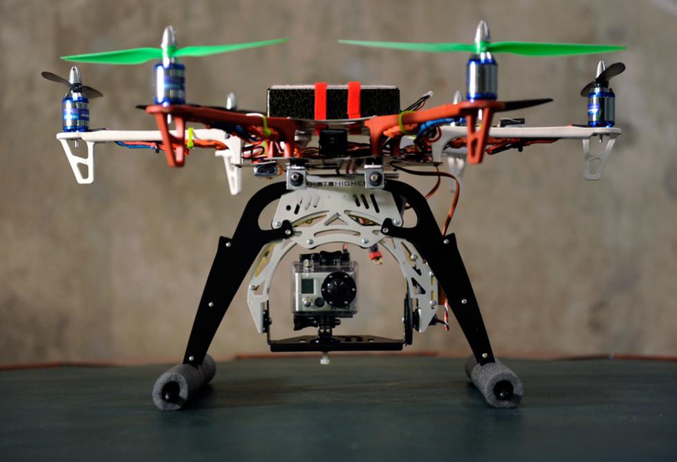

On a separate matter I'm looking to run two of these batteries in parallel to get longer flight times on a DJI F550 hexa I'm building. As it stands the power lead from the FlameWheel is 14 gauge and leads on the batteries are 12 gauge. Should I replace the power lead from the hexa to match the battery leads or is the current draw insignificant enough not to matter? I already have a parallel harness for a couple of 3s batteries I've been using but that is also 14 gauge, is that usable?

if you go into your "settings" menu in the charger your gonna find something called "voltage cutoff", change that to a higher number or just dissable it. all 5 or 6 chargers i've been through the last 5 years have had it. they also have a "time cutoff" set in there usually to 1 hour, dissable that too
You won't need more than 12 gauge going in unless it's unusually long
that should have said doesn't need thicker than 14 gauge...... it's early, makin coffee still
the current draw IS insignificant enough not to matter. Your looking at pieces of wire 6" long and a max current around 50-60 amps if you flew it like you stole it, hovering is 20 to 30ish amps. nothing needs changing, in fact i prefer thinner wire on the craft so it flexes easier to plug it in and stresses the solder pads on the bottom plate less
