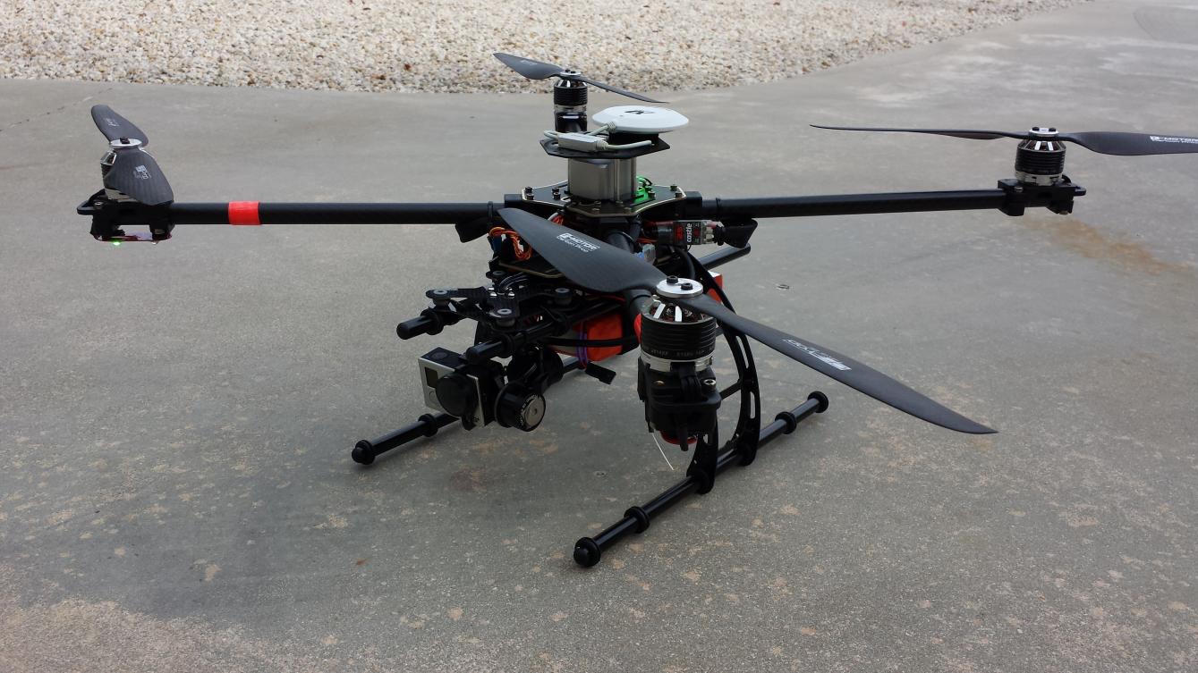

fltundra
Curious what size and brand are the props? Which KDE motors? And how long are your booms?
Nice clean setup, how well does it fly with the SX? You must hover at 40%.
Between the Kde's 515 kv's, Castle esc's, and the SuperX, I couldn't be happier. Flies really good, 62% hover with 14' Tiger cf's. Aerial mob booms end to end are 13.5 inches.
