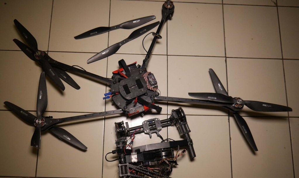

Yes, its a vulcan, it's more like an AK47. Crashed once, easy to fix/took only one day to change 1 arm & re assembly. Flew perfect on 2nd day for another job. Simple design, very robust. Love it.
