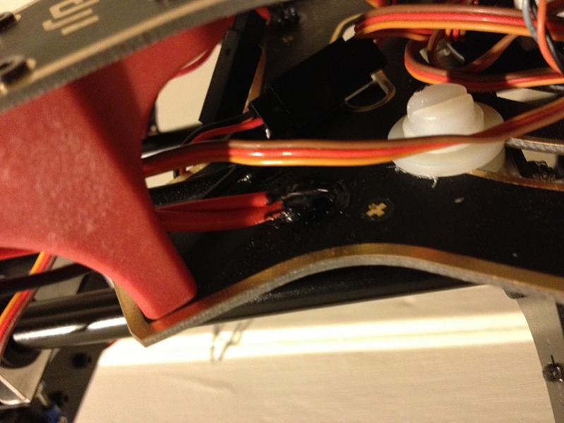

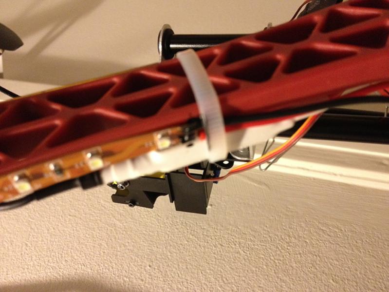

Hi, I have led strips from HobbyKing, motor 1, 2 white, motor 3 red, motor 4, 5 orange and motor 6 green. I just soldered them to the power board on 4s, work well and doesn't get hot.
Works really well for orientation, even in daylight. At night.... WOW!!

Really? Soldered them straight to the bottom plate power points?
If it's as easy as that then that will be something for me to do at the weekend..

Yes, soldered the ledstrips staight on the powerboard. Well did a test with a ledstrip on a 4s lipo, let it burn for a half hour. No problems. After installing I isolated all contacts with plasti dip.
Nice, thanks Fransvh, I'll get soldering at the weekend.. :)

I second fransvh's suggestion solder straight onto the power board, that's what I've done, but mine's slightly simpler, green LED strip for front two arms and red strip for the back two arms.
Happy landings.
