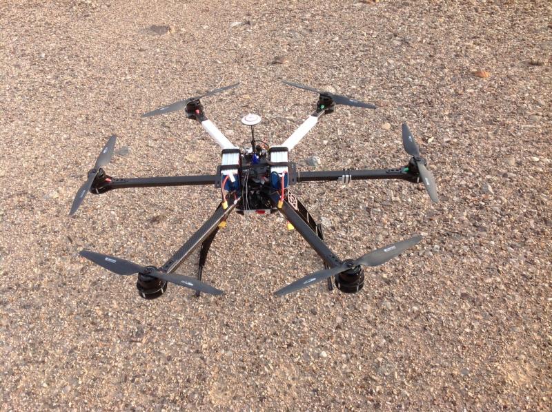

First - Quinton; - Thanks for starting this thread. I made my maiden flights this morning for my HexaCrafter 1100L with Tiger Motor U7s and T80A ESCs. It did well with my A2, even though the LED unit is missing the green LED, I got the required number of GPS satellites quick. I used a Futaba 8FG Super and decided to use the SBUS on the receiver that was packaged with the radio: R6208SB. So I bypassed the A2 FC receiver and I upgraded the A2 to all of the latest firmware, and used the iPad application to monitor parameters of the A2 (I will see what I need to do to get a new LED cable form [MENTION=10610]aerial[/MENTION] Media Pros; ). I hooked up my iOSD II without a monitor to just act as a 'black box' and it worked fine. I did it because I was a bit nervous about using the A2, and I wanted to record a log of the flight. I have a couple of questions that I will list below the dropbox link.

- This link is the two of 18 files the unit made this morning (the last two) using my DJI iOSD II the files ranged in size from 768 KB to 377,216 KB. this link is for two files: 77,472, and 213,152 KB sized files that seemed to be representative of the data collected. I read the 'full' manual and it seems to be missing detail about these logs.
1) Does the iOSD II make a new file every time the motors are turned off - indicating I landed and turned off the motors 18 times? Since it was the first time I flew this rig I did a lot of landings. - from video answered: Yes
2) Am I missing a data point for the number of satellites that the unit is reading from? - from video no indication that this data is captured to bad this is not recorded
I guess I answered my own questions from the video that Quinton started this thread with. [MENTION=1417]kloner[/MENTION]; that SuperX log is a really good user friendly display - I wonder if the iOSD II data will ever be a bit more user friendly? I would appreciate any comments on the log.

motors 2 and 5 are pushing on each other,,,, might check there level.
Wow - thanks. I guess I will be taking my sanding block and straight edge to San Diego. I need to learn how to read the iOSD II data a bit better - will go back and take a look.

Thanks for the acronym SVN = satellite vehicle number; good to see that in the data; verifies that my green LED is burned out!
I think that kloner saw that motors 2 and 5 are outside of their respective groups i.e. 2, 4, 6 all spin the same way as do 1,3,5. They are not that close to their respective spin groups on the scale. They are opposite on the display when you turn off all the other data sets; and actually cross at points and trade high and low spots. He has been helpful with tips on balancing motor mounts; so they are all lined up on horizontal. Obviously I need to do a bit more sanding of my rectangular arms; the data from the iOSD II is a valuable tool.

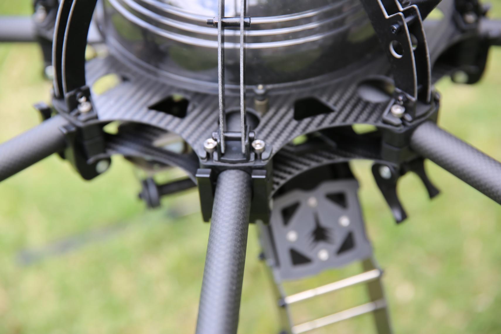

Just an update on this thread as I was having all the CCW motors being pretty hot, it turned out that one of my motors was around 6mm lower than others.
What I noticed on that motor is that that the o' ring in the boom was not under the plastic motor mount on the Skyjib, so dismantled it and made sure it sat under and tightened all the QR plates as much as I could, and now all 6 motors are cool after again.
So thank you again Kloner.
no problem. yesterday on set i noticed my rig getting weird in wind, i had to do the arm stretch up on all the arms and she cleaned right up.. it's a daily thing, gonna add it to my checklist
SMP
Arms stretch?? Developed a CCW hot issue as well. Re-leveled again the other day but haven't gone up on it yet... The 6mm lower however is something we've never checked, makes sense though. Whats the arm stretch upwards??? Give em a yank and make sure theyre all at the same height????
imagine balancing the rig on the ground using one arm, leaning 45 degrees, the opposing arm to the one touching the ground is in your hand...... give a big push to the crash cage, rotate one arm repeat, repeat till all are adjusted. You WILL hear some creaking, normal, just make sure all the arms are in the full dihedral option and she will fly bueno
