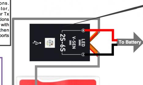

View attachment 8928To grab 5v power you could disconnect the two servo leads going into the naza and use the one that came out of the X3 slot into any of the ar8000 receiver ports to power your receiver. Then pull the offending esc plug out of the naza and plug it into the ar8000's throttle port, then do the cali thing.
and remember-Don't be a mench, deprop on the bench
