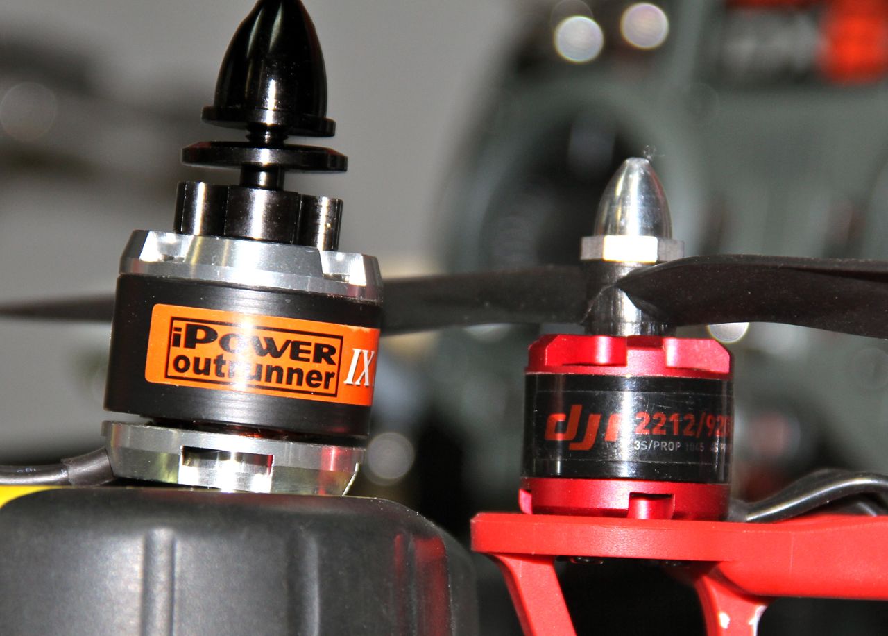

Figures, my new motors have a 5mm shaft and the only 5mm adapter I see listed is 13 dollars, I'll figure something else out on mounting the graupners. Amazing how much BIGGER these are...
tstrike
pendejo grande
Thanks, that's what I'm looking for, I'll poke around and see if I can source some 8mm od x 5mm id tube locally. I'm in no big hurry as I've only got one set of graupners with a spare for each direction, the cheap props I got for bashing around fit the motor like a glove.
