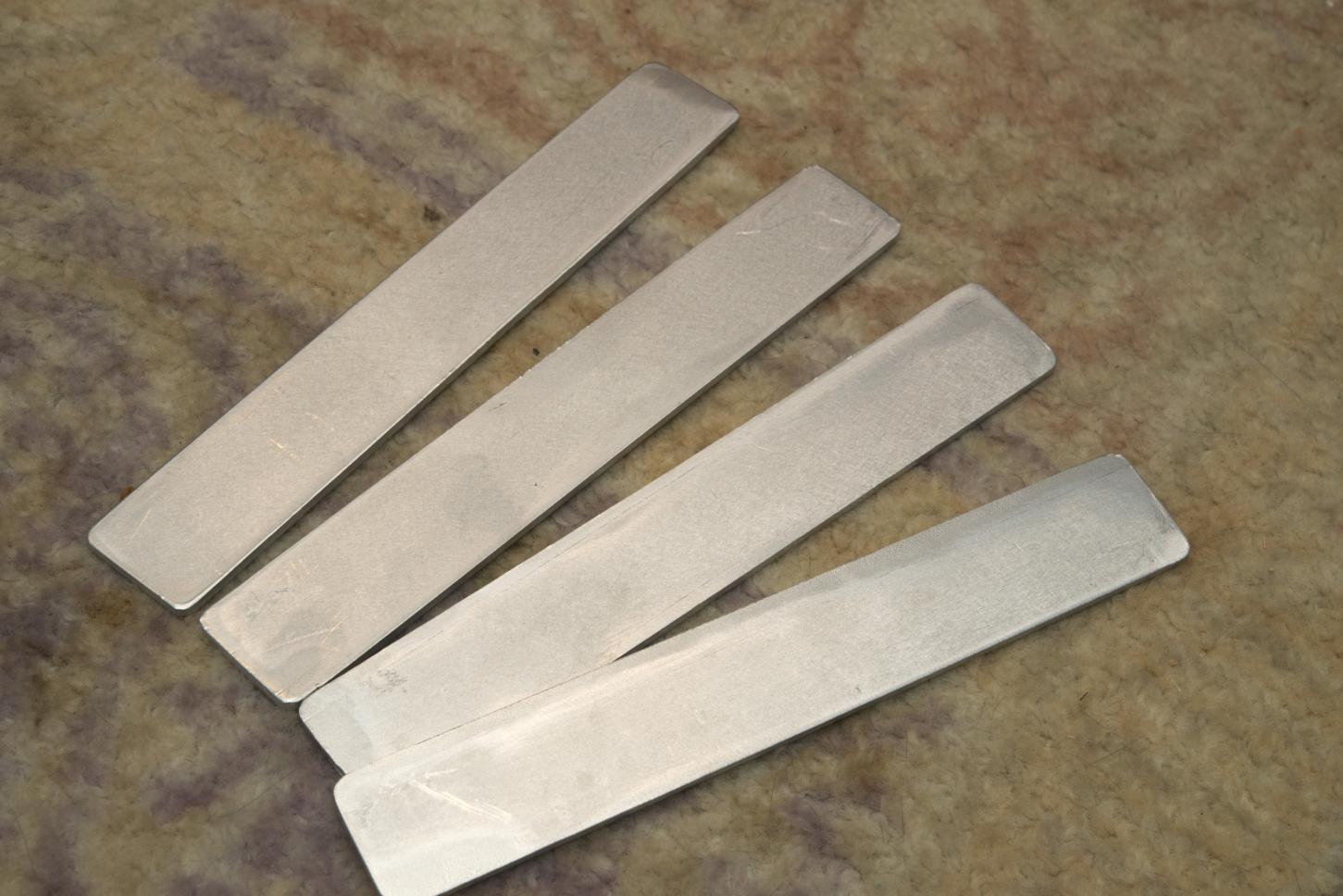

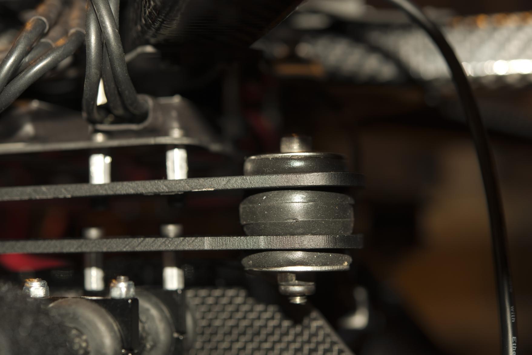

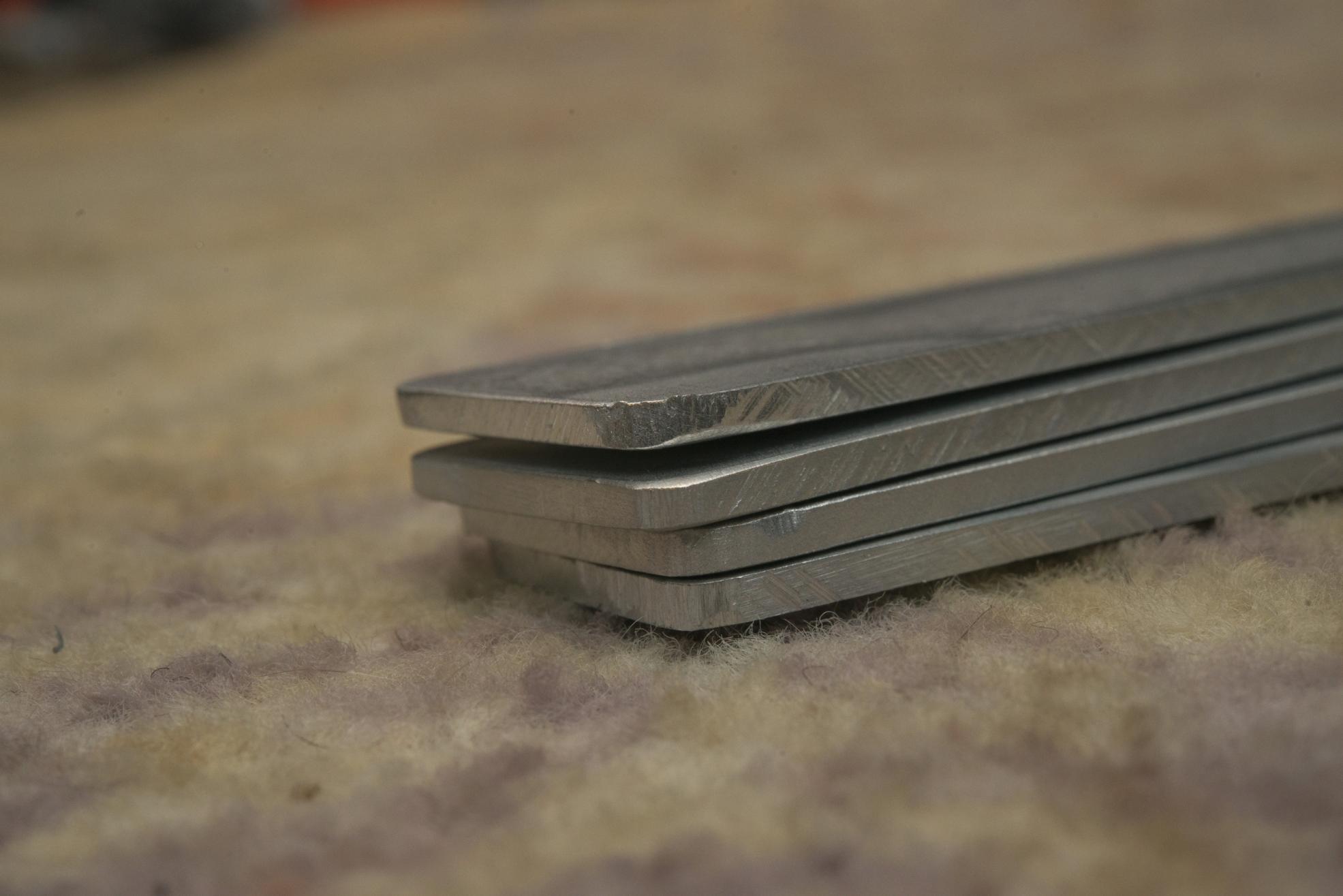

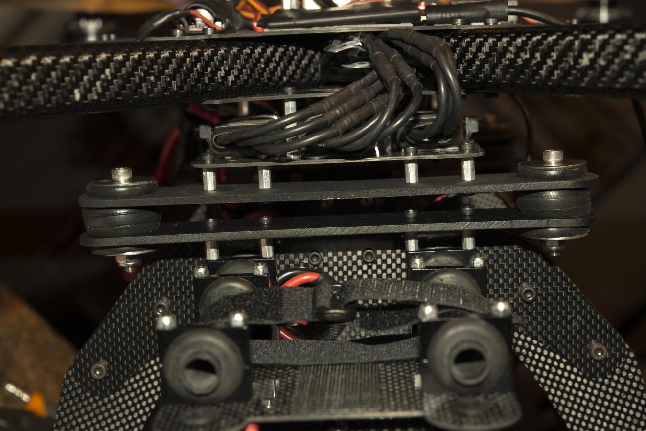

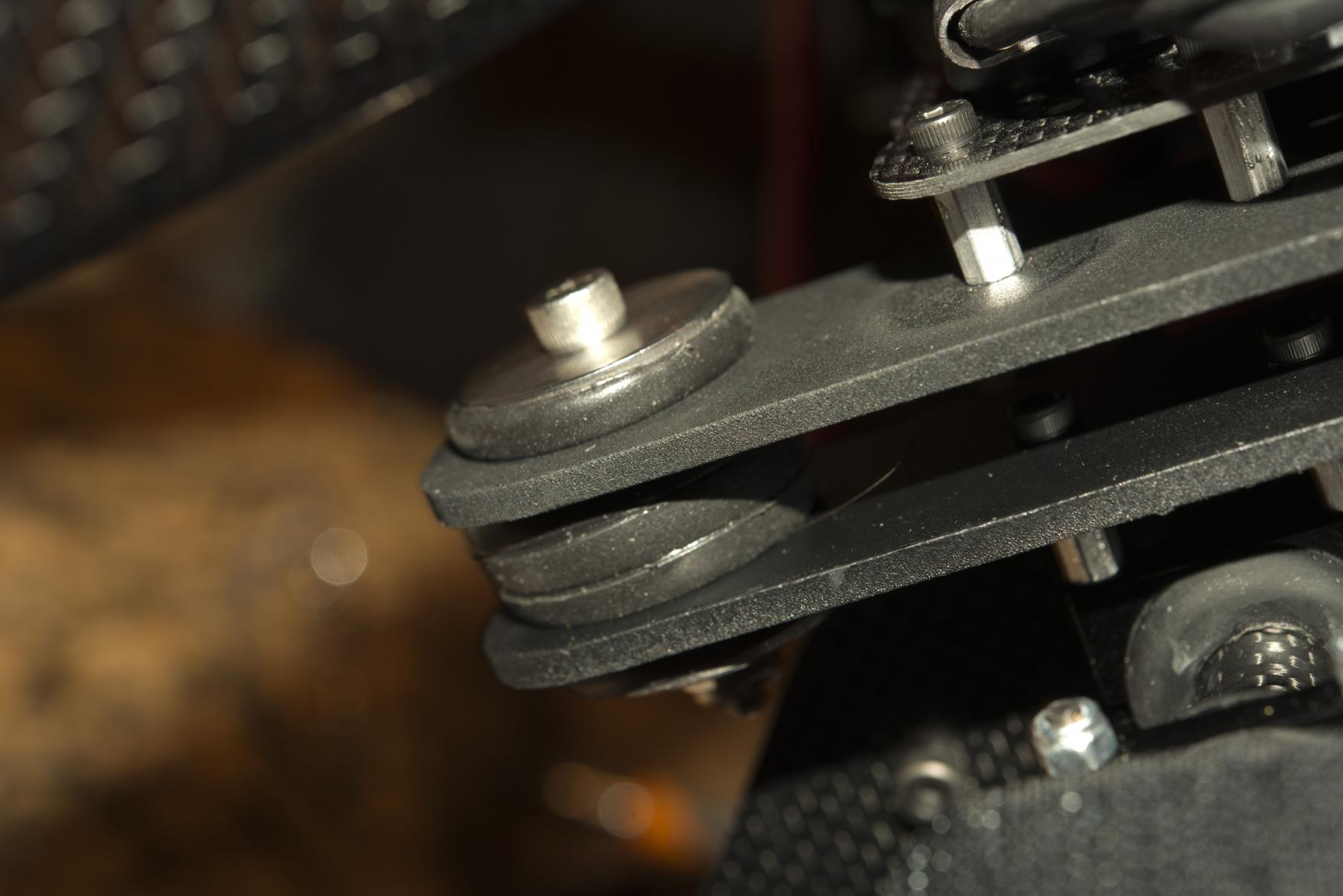

To improve on vibration reduction I did some modifications to the HC800. I had some good results by using a material called Sorbothane in my F550 build so I thought I'd incorporate it into this build.I started by cutting down some aluminum plating I had to these rectangular shapes: View attachment 12153View attachment 12154 Drilled some holes for the Sorbothane bushings and to attach to the HC frame and painted them flat black. View attachment 12155 Here are some photos of the completed assembly. As you can see that the Sorbothane completely isolates the two aluminum plates so there is nothing solid connecting them. I'll do some tests and see how it works. View attachment 12160View attachment 12156View attachment 12157View attachment 12159View attachment 12162
