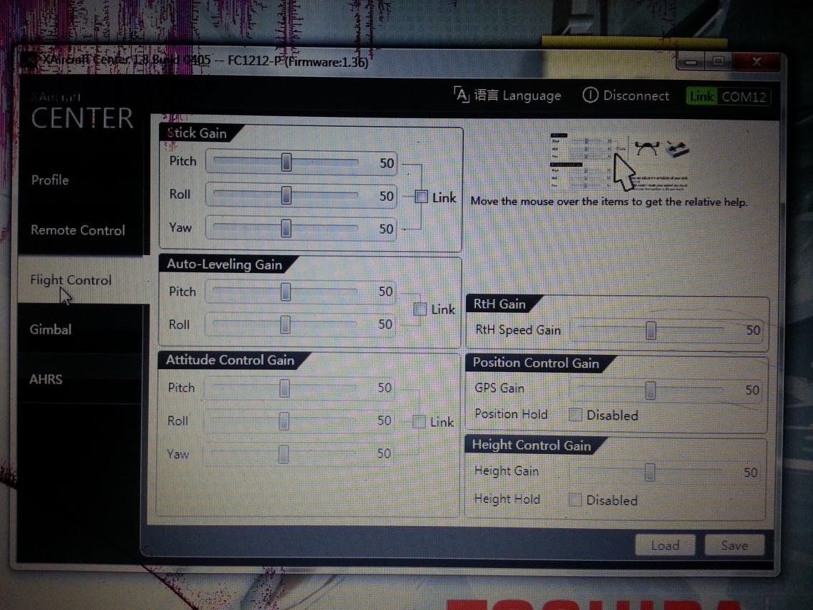

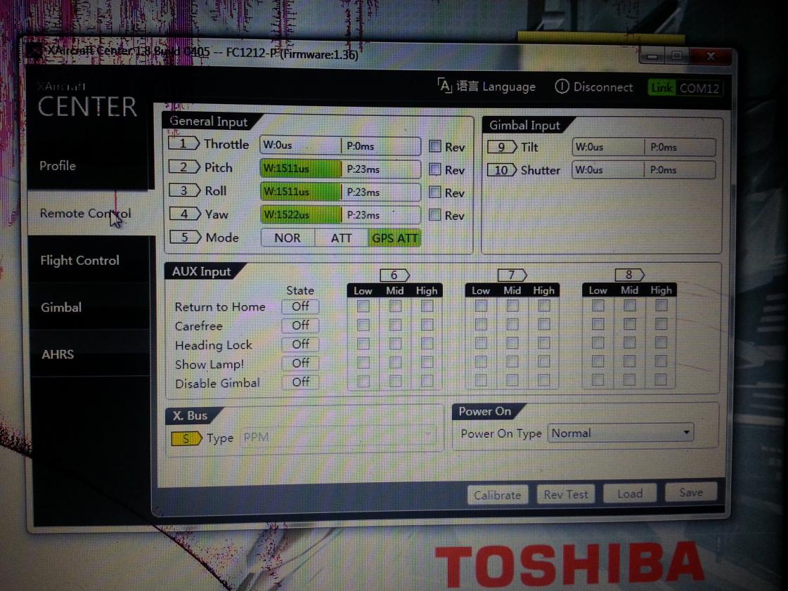

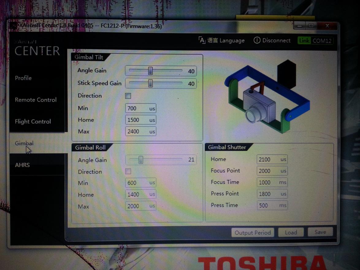

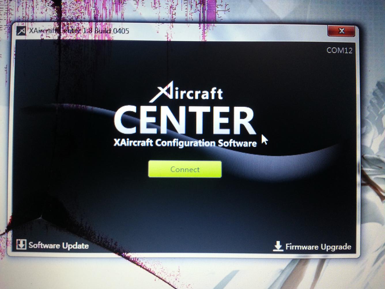

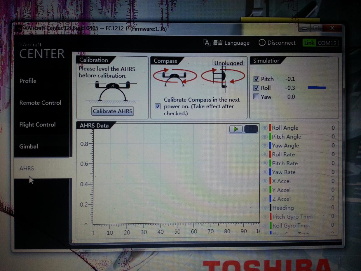

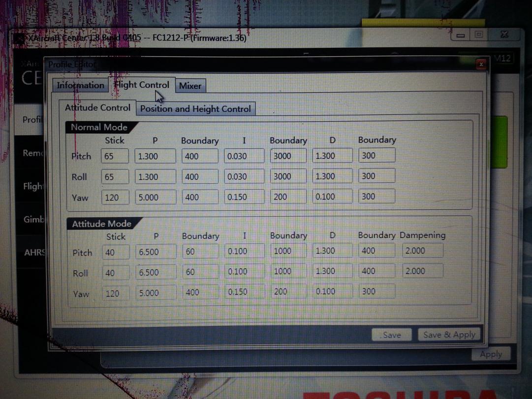

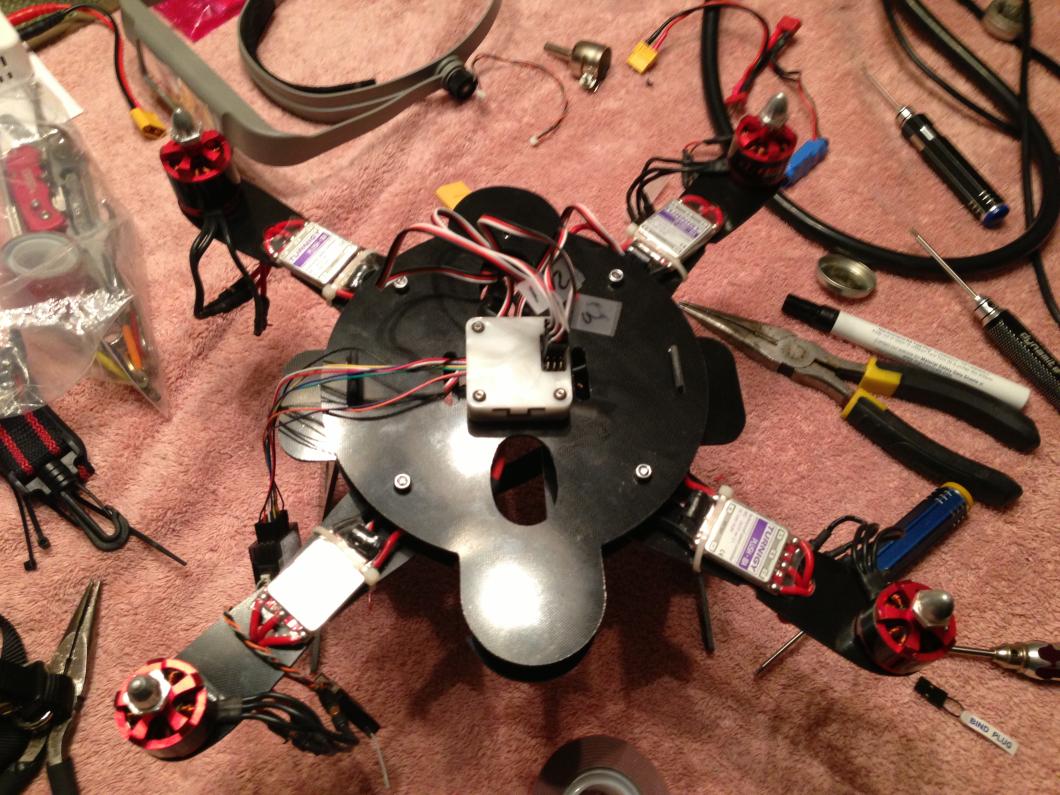

Can you post some screen captures of the XA center?
Go page by page and capture every page, maybe i see something wrong.

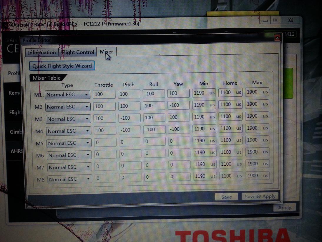

vadmcse
Are you testing with 4 or 8 motors?
The custom profile you are using, was created using the "quick flight style wizard"?
I see you have the flight mode switch in GPS ATT mode, put it in ATT mode, and remember to test ONLY the FC and AHRS. The GPS and AUTOPILOT, should be disconnected.

vadmcse
Ok, let me make some tests on mine, but i have to unmount my XA ESC's and motors and change it for normal ones, so it will take time
awesome victor, thanks for helping me this far. i have those 12 amps ESC's high speed controllers or whats it called, thats what the XA shop sells to
vadmcse
ok, tested
Unmount my FC from my 650 and mounted it on my Turnigy HAL project
4 RCTimer 40A Simonk flashed ESC.
4 Turnigy Aerodrive XP SK4240-750 motors
NO propellers
2 Turnigy Nanotech 4S 5000MAh 35-70C in parallel
Created a new profile on the FC using the wizard for a X quad with normal ESC's.
Connected and..................everything worked as expected, in all throttle range, from min to full.
So, you can test only one motor and ESC on the FC, disconnect the other 3 and test.

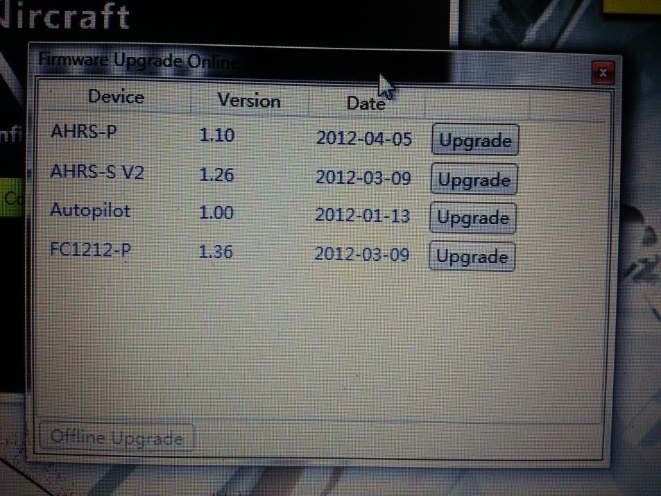

If the problem continues, then reflash the FC with the latest firmware. I know you already did it, but many people had problems with firmware, even after flashing many times.
If it doesn't solve the problem, test another ESC and motor, if you don't hav 4, don't worry, you only need one to test.
If you want to send me 1 motor and one esc to test it in my FC, no problem
If you want to send me the FC to test with my motors, no problem
If you want to send me all the quad to test it, no problem.
I don't know what else to do, and regards the NAZA fc, i'm sorry, i don't have one, so i can't help you with the testings.
Let me know your progress.

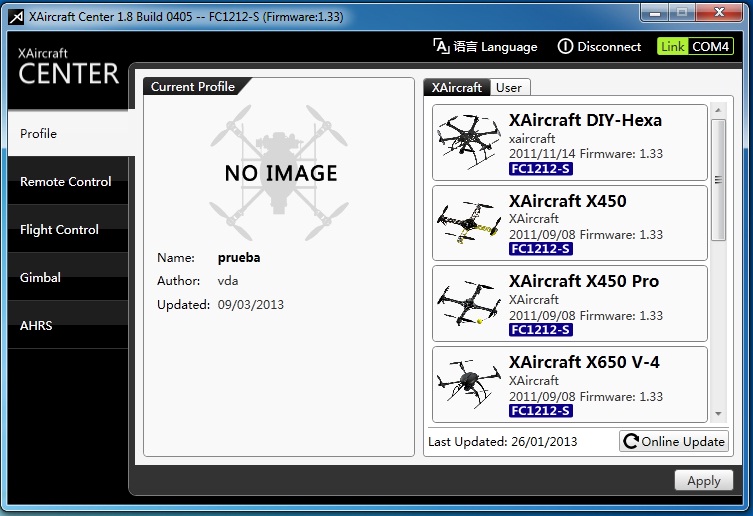

Can you make a screenshot from the quick menu? so i can use your settings, maybe that helps a bit..
vadmcse

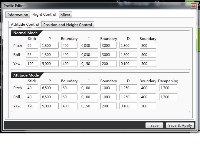

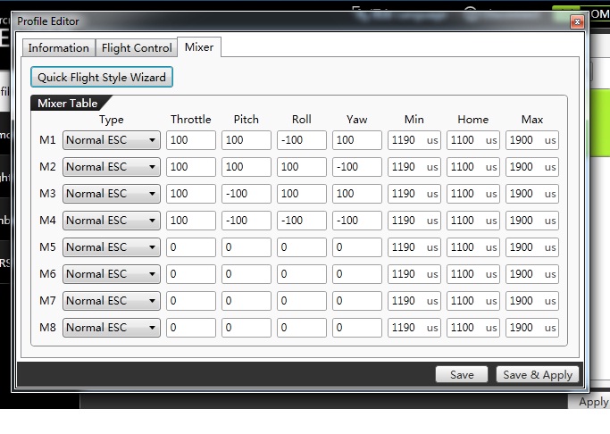

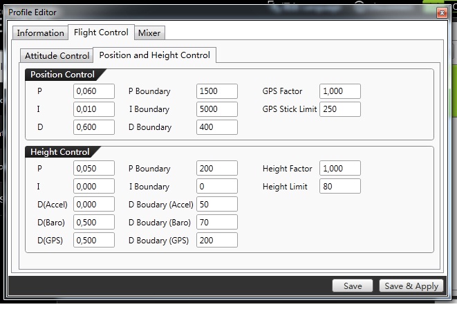

Here is

Ok, send me your Email address by PM and I'll send you a copy.
The file is not in the XA site, they deleted it.
vadmcse
Hi,
Ok, i have the 1.36 version, is the same that you already have, but if you want to give it a try...
Send me your Email address, i'll send it
