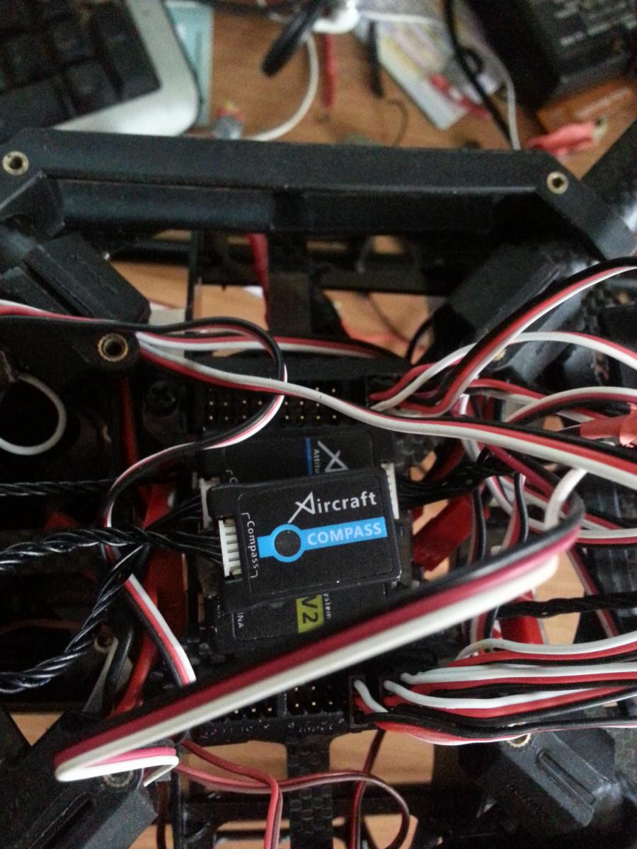

Could you post a close picture of the FC with all the cables connected?
Is this the first time you try to fly this multi?
Was it a V4 and you transformed into V8?
No this is the v8 and always was the v8, its now v4 because i want to see what im doing wrong.
Instalation isnt hard, in the output you put in m1,2,3,4 in socket 1,2,3,4, and the controls is also easy enough. i just DONT get it whyit doesnt start as it should. ihave to do a full trottle and if iuse tje roll and pitch only one motor runs at a time. as example the rght stick in the upper right corner the fronttight motor starts spinning, if i let go of the stick motor shuts down... and im beyond understanding what i did wrong. you cant ***it up if u follow the guide wich i did

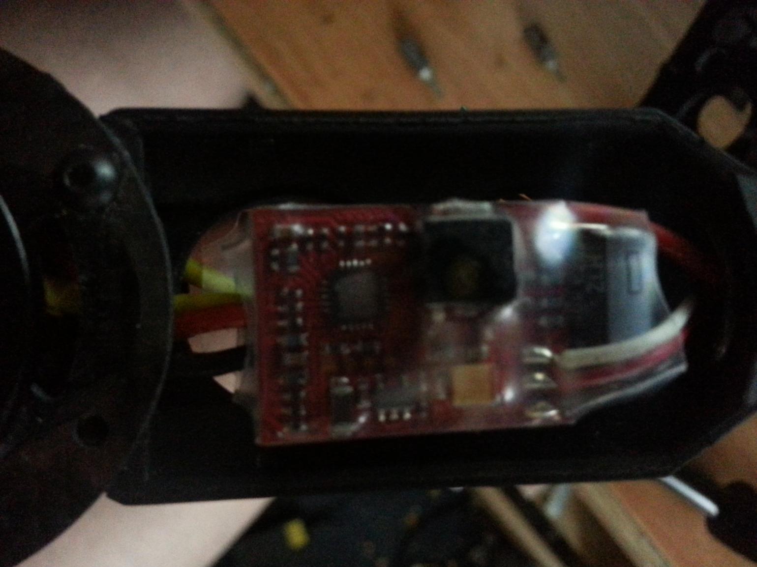

Could you take a clearer picture of the ESC? I suspect that you are using normal ESC instead of Ultra PWM
