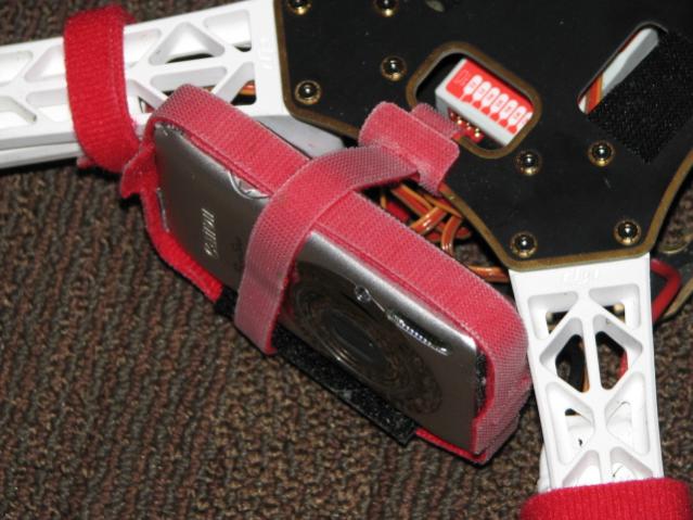

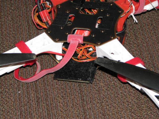

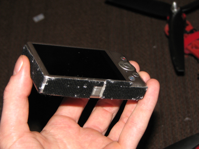

From what I can gather from other threads, you want something with a little give so it absorbs vibrations, but not too much. Not too thin, and not too thick. What is the ideal?
I'm currently using a ton of velcro. Velcro between camera and PCB, a velcro strap all around to hold it down, and a 3rd strap to keep it moving front-to-back a little. See pics (I strap it on tighter than it looks when I'm actually flying). A pretty rough setup - I'm especially unsure about how well that 3rd strap prevents front-to-back tilting. See the video below for a demo of the vibration I get. (This is with stock props; forthcoming APC props and balancing everything will also help a lot)
The protruding piece of the PCB is supposed to be flabby enough to contribute to vibration. I got some landing gear, and have a whole bunch of sketches I kinda want advice on for how I might hard-mount it beneath the center of frame using a little balsa jig. I decided the question I've put forward here really needs to be asked before anything else, though.

It sounds like extra points of contact (e.g. my 3rd strap on top) is also a bad idea. The problem is the base of my camera is only about 15mm wide, so even with a strap running round underneath, it's going to wobble forward-back. To minimize points of contact I may use a tripod screw to attach it to a wider piece of balsa/plywood, then stick the entire piece of wood to the frame.

That front flap it's mounted on in general wiggles with weight on it

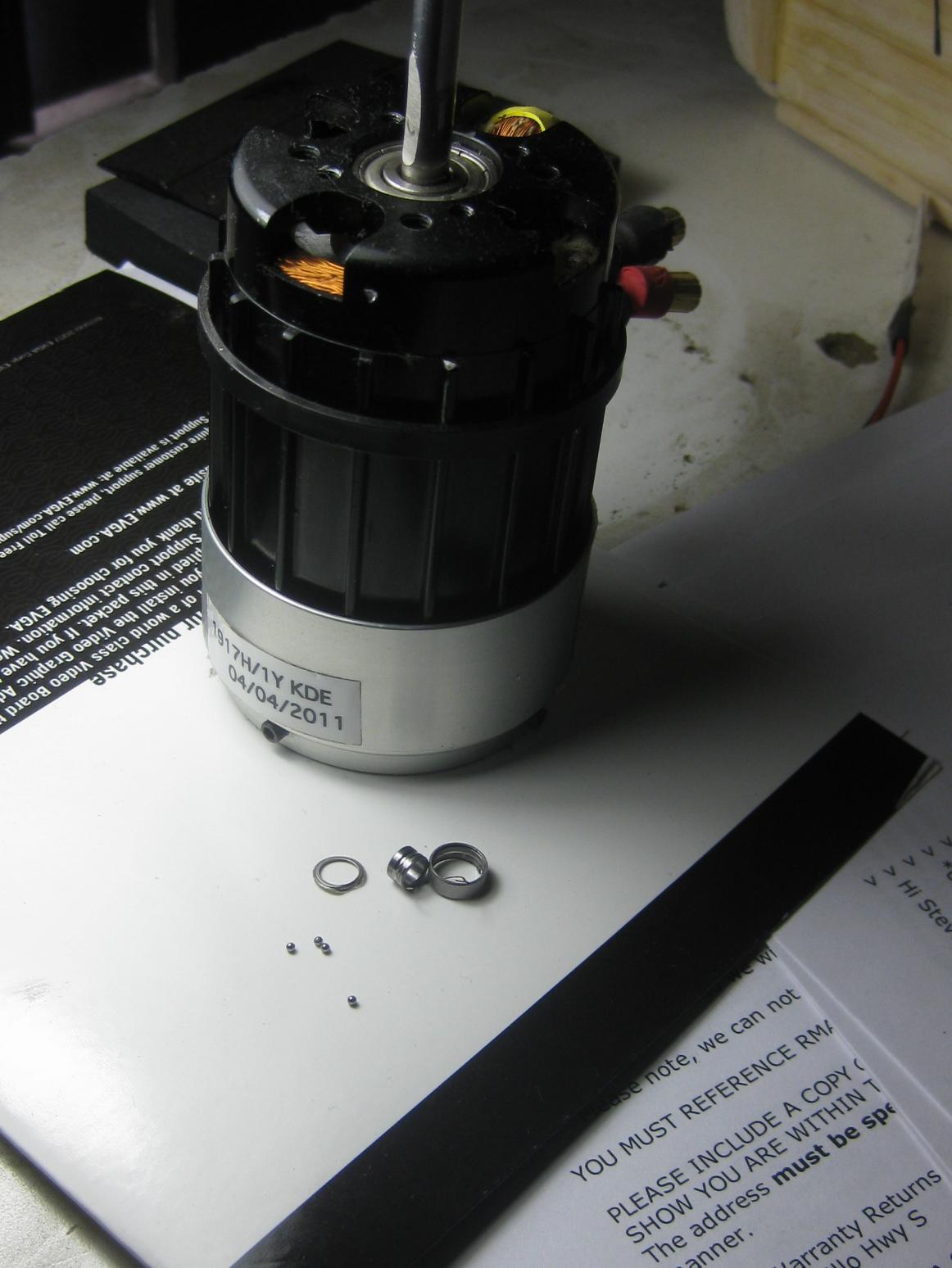

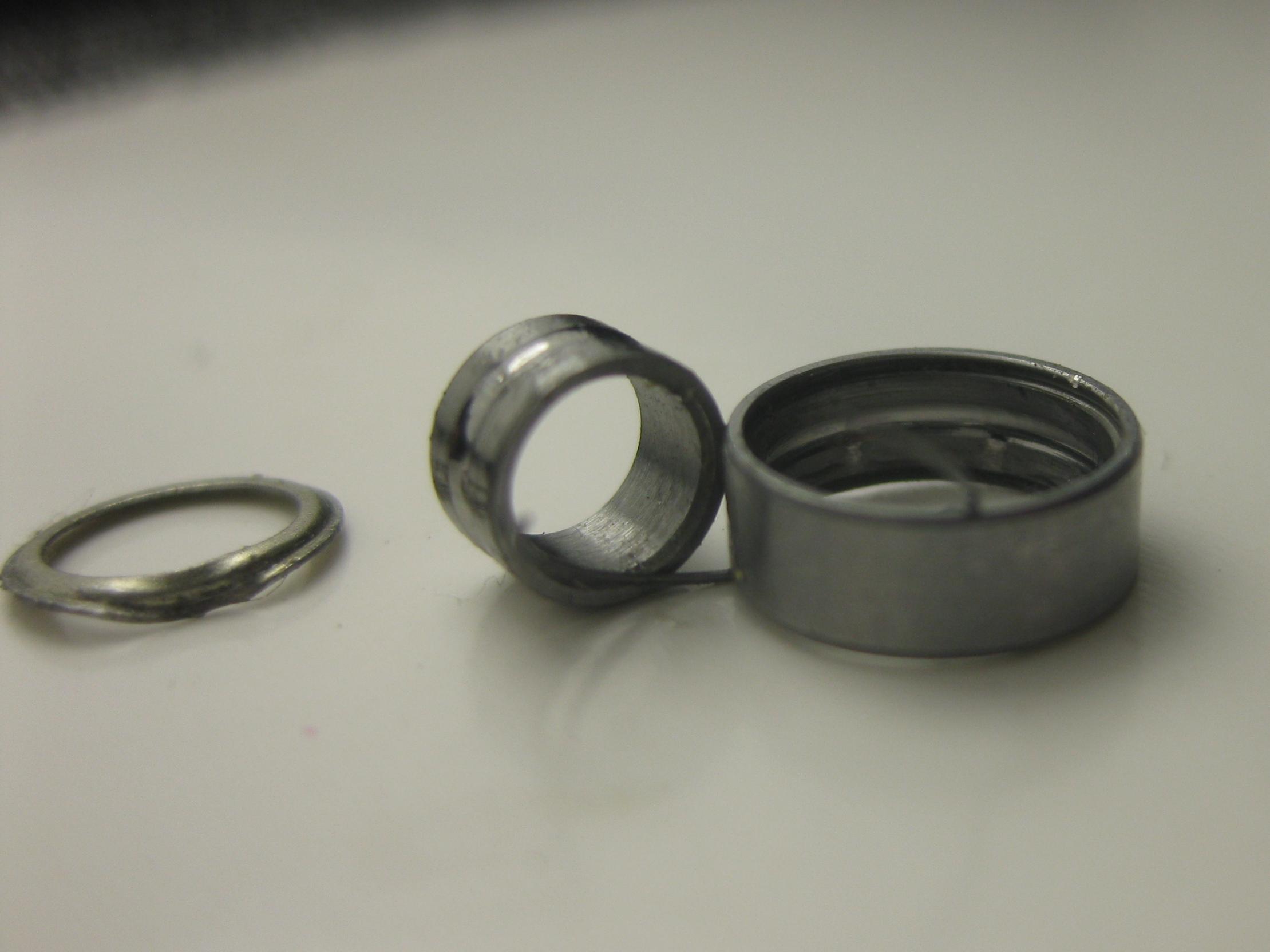

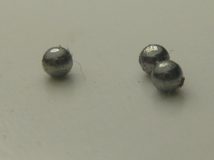

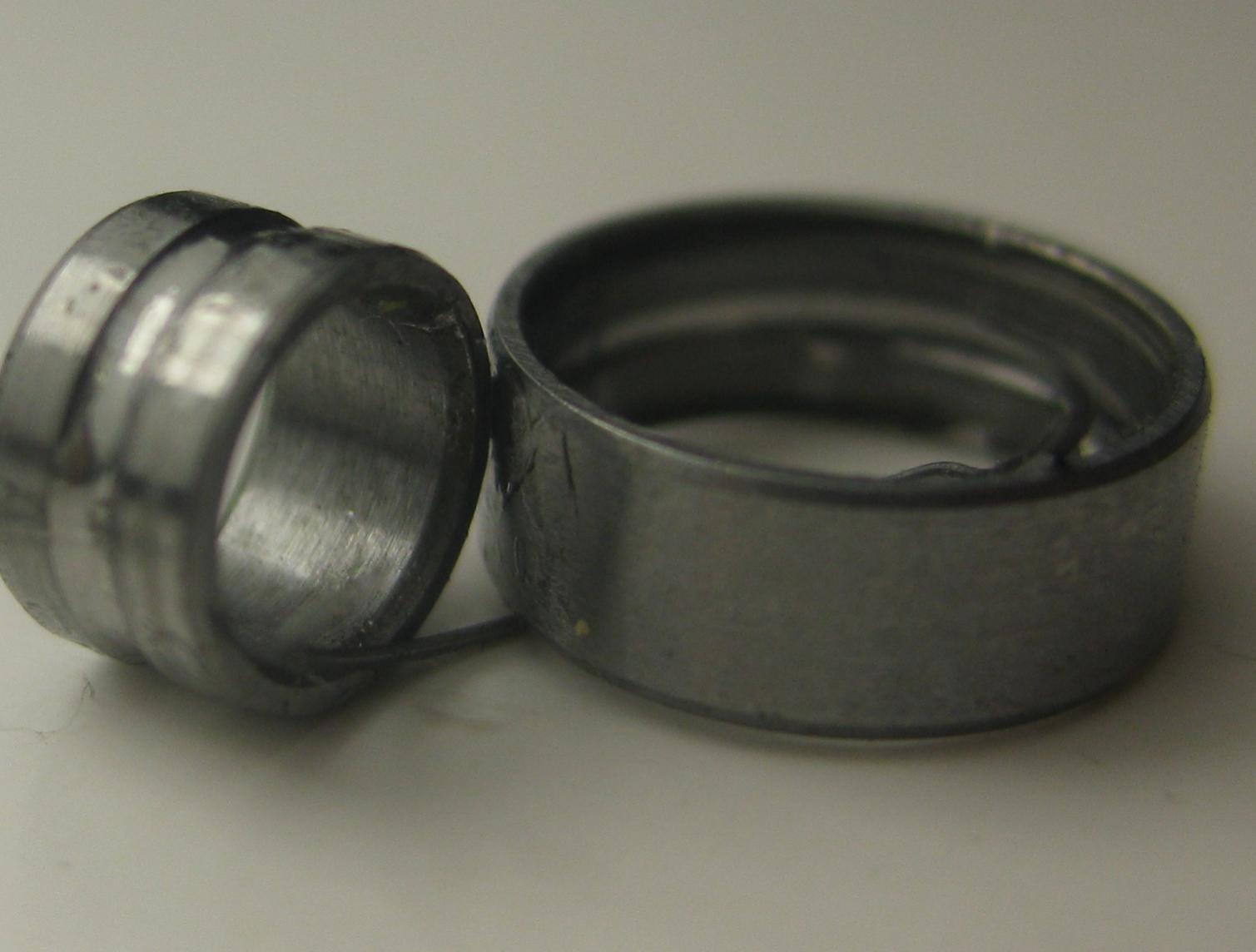

All that said i have 7 bearings sitting here that flew less than 10 minutes before i decided to throw em at the ground and smashed em. I just took and blew one apart with a pair of dikes so we can see exactly whats inside a dji 2215 motor bearing. I gotta post em from another putter, i'll be right back
View attachment 2769View attachment 2770View attachment 2771
is there grease in there? Definately not packed like a wheel.
BTW, the 4035-400 i burned up was running a governed 10,000 rpm, in scale heli rated for 3500 watts and never got over 1200 watts

The only time i've killed a brushless motor from oil was on a KDE direct NEU 1917, that's there big 10,000 watt output motor. i was having a vibration problem later found was a lash deal, but i dropped 20 or so drops of oil in a week period. the insulation on there inrunner was a cardboard type substance and the oil softened it and the stuff started flying out of the motor

I'm thinking about trying to add some struts to the bottom of the PCB to make the front flap a little stiffer. Maybe two 1/2" x 1/4" x 5" pieces of balsa mounted in parallel fashion, with the 1/4" making contact. I wonder what adhesive would allow me to remove them easily while still being functional? Maybe loctite quickset epoxy would be ok, I'm not sure I could chisel it off though. Silicone glue would be nice, but there might be enough play in between to allow vibration. Hell maybe just a minimal amount of cyanoacrylate would be best.

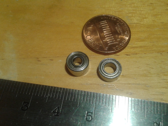

kloner man. Those bearings are not the right size. The ones in my motors are I think 3 x 8 x 4, just like people were talking about in that other thread. Did you get this mixed up, or does DJI have two different motors it has shipped out with f450 kits? I should have took the motor apart and checked beforehand, but shoot.
Bearing from the DJI motor on the left, unfortunate boca 4 x 8 x 3 on the right.

I have the 3s kit that came with the 2215 and mine are like i told ya, then mailman got his in the other day and his were wrong. Sorry bro, didn't know you guys got 3mm shafts, mine are 4...... Now i know,,,,
he said the 3x8x4 were what worked in his 2212
if they try dingin ya returning them, let me know and i'll give ya what ya paid for em and send them my way. can always use some spares.
Dune
Yeah I have the 2212. Didn't know there were different ones that came with the f450.
