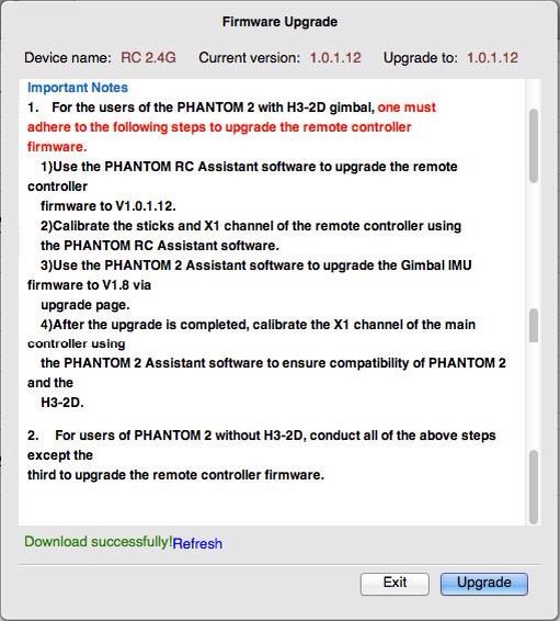

Last night I upgraded to firmware 3 for support of the H3 2D gimbal so I can adjust the tilt and speed. I upgraded the phantom assistant software first then did the rc assistant. Aparently it should have been done this way around but never saw this screen anywhere.View attachment 17853 Someone else showed me this screen. Although I can adjust the gimbal but cant use the 3 toggles to adjust horizontal and vertical tilt and speed.
Is there anyway of getting these working now I've done the upgrade. Thanks

You are correct. RC Assistant first the Assistant. The Horizontal the Vertical tilt are only for FPV in my understanding.
IBBuk
I have not reliable source to prove this or quote from, but those settings maybe for the H3 3D 3-axis gimbals, not the H3 2D gimbals. For me at least, they seem to have no effect on the 2-axis gimbal.
