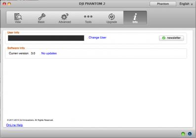

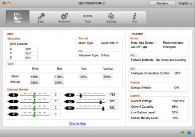

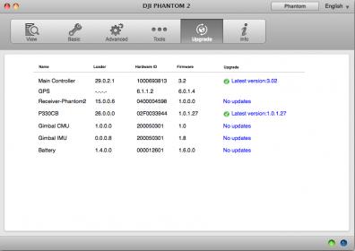

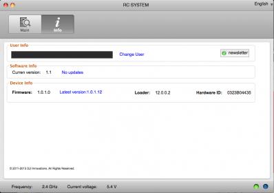

So today I bound the original tx to the P2 to run the RC Assistant then in the P2 Assistant as suggested. At first the video was a little shaky but it seemed to get steadier after about a minute in flight. I still have no discernible control over the tilt gain control, right now it is set at 5 which should be very slow but I see no difference between 5 and 100. Everything on the gimbal tab seems to be in a little brown color almost like it is disabled. Maybe I'm used to seeing the adjustment parameters in black if they are effective but not sure if this has anything to do with it. Do I need to be in NAZA mode or in the normal Phantom mode in the P2 Assistant for this feature to work properly.
You need to calibrate the X1 channel, i.e., tilt in both the RC Assistant and then in the Phantom Assistant. That will fix your problem.
