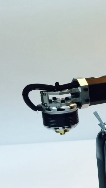

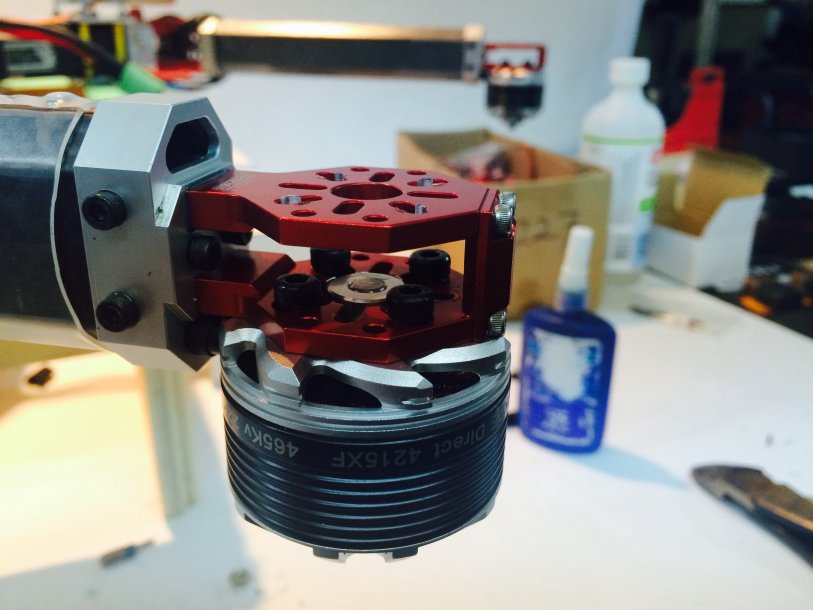

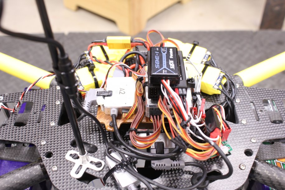

Not much going on here. I wasn't happy with the way the motor wires were. The looped out the back and it really bothered me. I will post a pic of the before and after in this post. To get them to go directly into the arm I needed to drill my motor mounts out to accept a 4mm bolt. So that's exactly what I did.

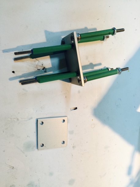

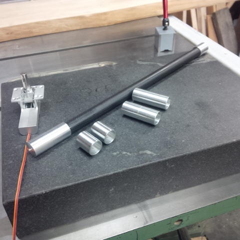

I got my retract mounts made. They are not pretty but they are solid and clamp very tightly around the arms. Necessity is the mother of invention, isn't that what they say?
Just waiting on some aluminum parts from the machine shop to mount the legs.

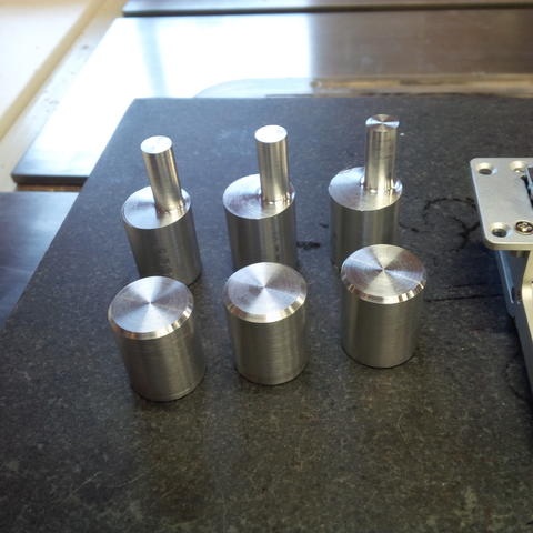

View attachment 23214 View attachment 23215 View attachment 23216 View attachment 23217 View attachment 23218 View attachment 23219
Btw. Those legs are 20mm dia x 420 long. The long aluminum pieces you see here will have a 10mm pin turned on one end to fit the retract. It will replace the steel pin you see here in the picture. The short aluminum pieces are just end caps.

Let me know how that adapter rod works out. I've been thinking about making something like that to work with my Dubro balancer.
Pumpkinguy
Aluminum parts are finished for the retracts. The 10mm pin is offset so that we can use 20mm cf tubes with those retracts. If you fold don't understand I will post a pic when they are mounted.

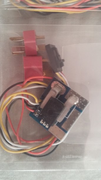

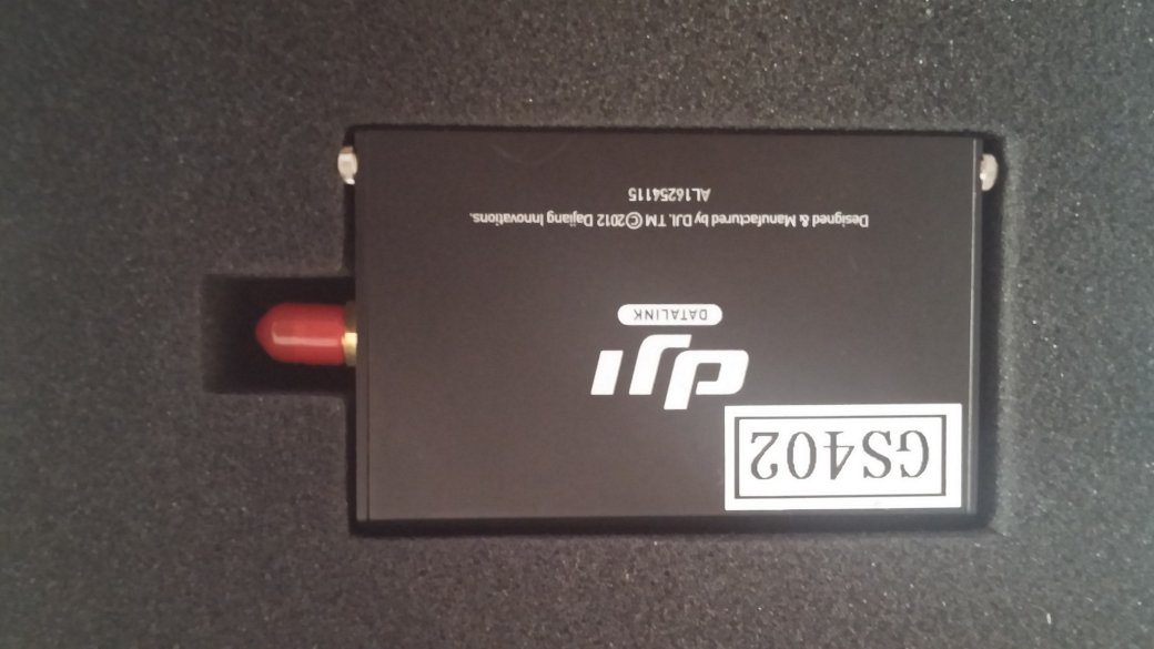

Also, got my brand new, never even opened wookong today. Good ebay find @ $420. I got a brand new iosd mkii on ebay as well. $150 and I also picked up a v2 imu. I will use that and keep the plastic one for a spare. View attachment 23251View attachment 23252View attachment 23253
