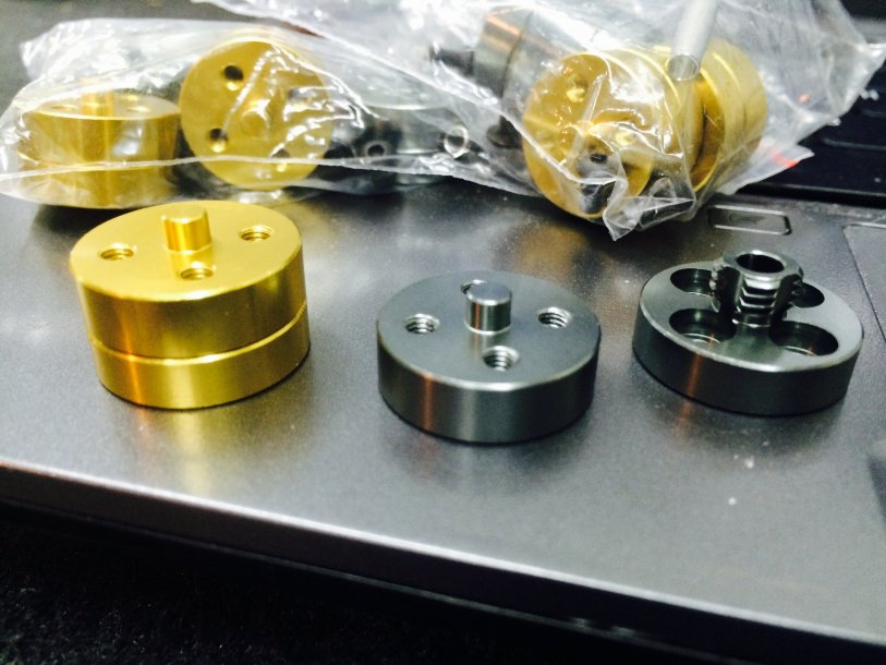

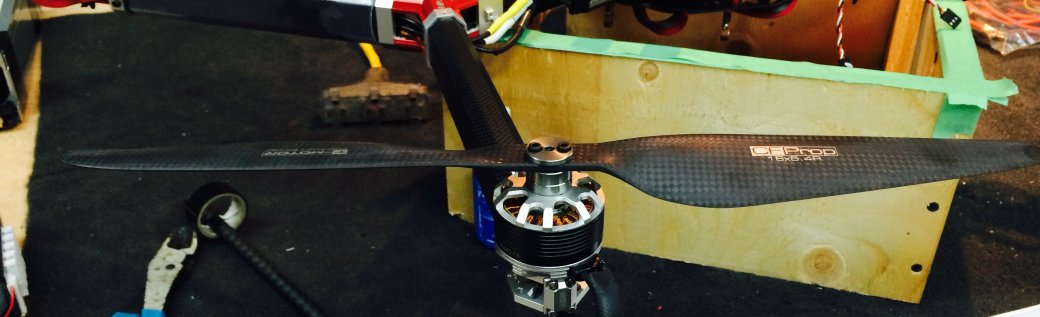

I wonder how safe they will be with 17 o 18 inch props. You have a lot more momentum with those props than lets say a 15 inch prop. As the motor slows down I wonder if that momentum is enough to unwind the adaptors. These things are a great idea so I hope someone can chime in who has used these things successfully with props of this size.
Pumpkinguy
There will always be load against the threads. Sometimes less load, sometimes more but there is always load. It's not like the props will suddenly brake or change direction.
I know what you are saying about inertia but the props are so light there is a very low rotational mass.
Pumpkinguy

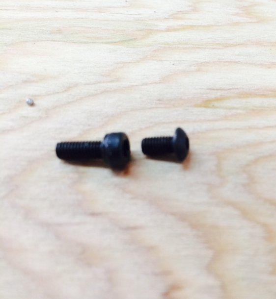

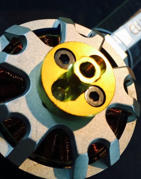

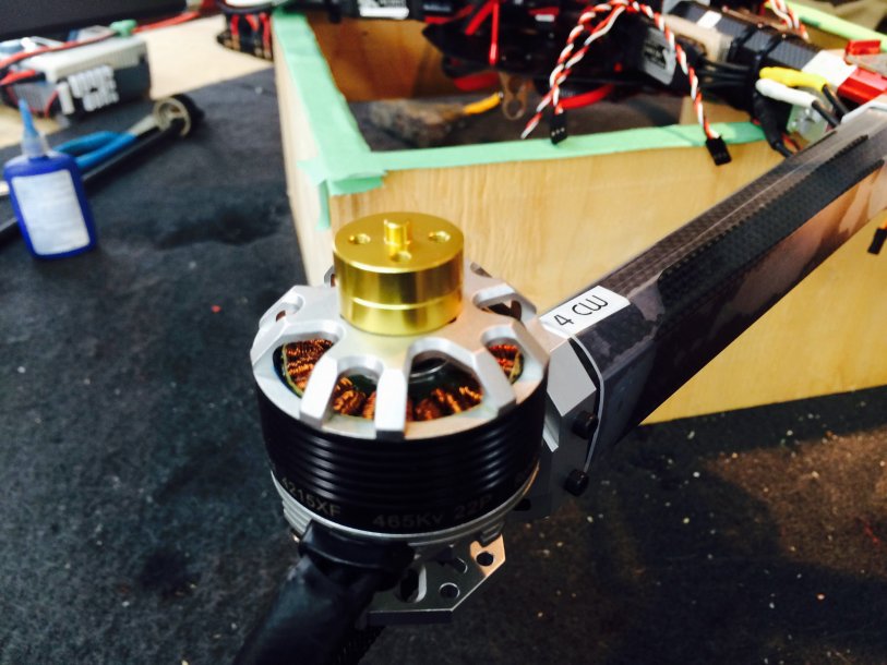

I installed the prop adapters. I replace the very short button head screws that came with them with a high grade socket head cap screw and torqued to 15in/lbs. I hate button heads and have no idea of the grade. Plus they are so short they only get 3mm of engagement. Loctite is a must here. I did have to take 10 thou or so off the socket caps so they didn't sit proud of the surface. Another advantage of the socket caps is they will never be able to back themselves out. View attachment 22670View attachment 22671View attachment 22672View attachment 22673

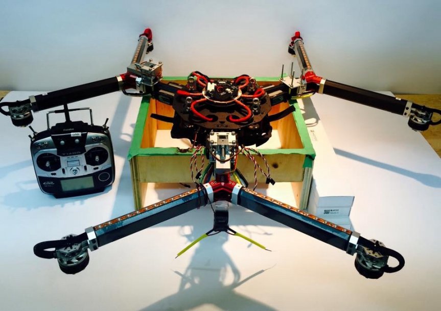

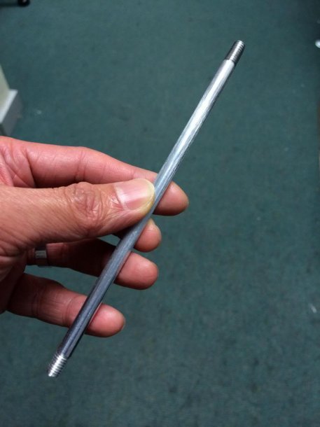

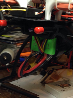

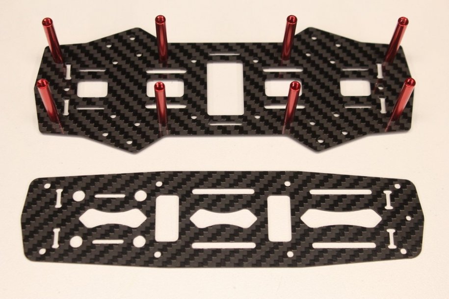

View attachment 22871 Designed a mount for my retracts. Just waiting on some aluminum parts from the machine shop to mount the 20mm x 420 mm legs. Then she is pretty much done less flight control. Ya. I've had flight control issues. At the present time I am without one. Trying to decide what one I will use.
She is bang on 8kg with 2 x 6s12000.
