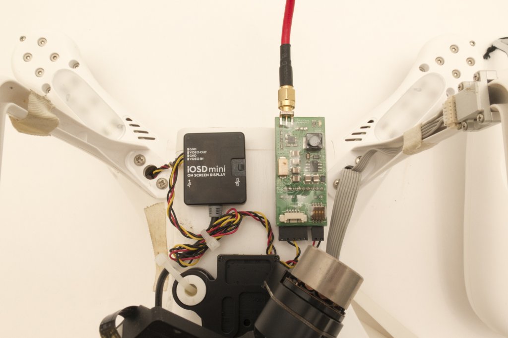

Looks like this one only handles 500ma For VTX. Can not figure out what the other one handles. I usually use 600ma.
and the RedRotorRC-RROSD PRO from ReadyMadeRC
http://www.readymaderc.com/store/index.php?main_page=product_info&cPath=76_639&products_id=5096
upload_2016-1-26_11-55-17-png.27380
I haven't looked at video tx power consumption but keep in mind it is easy to just power the vtx via the main battery power via a tap as most vtx will take higher pack voltage where cameras are usually limited to 5 or 12 volt

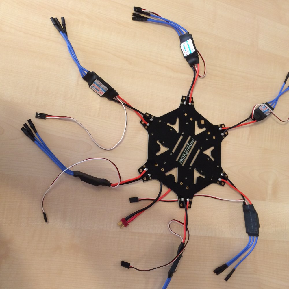

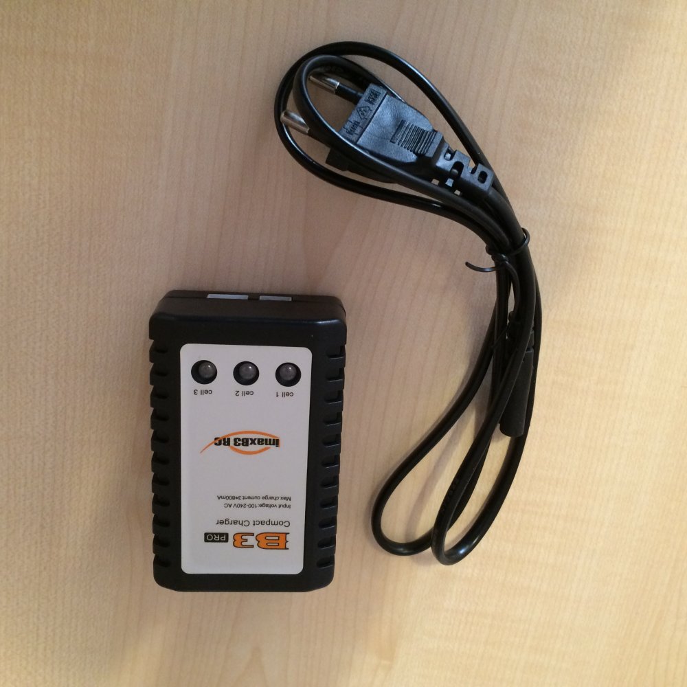

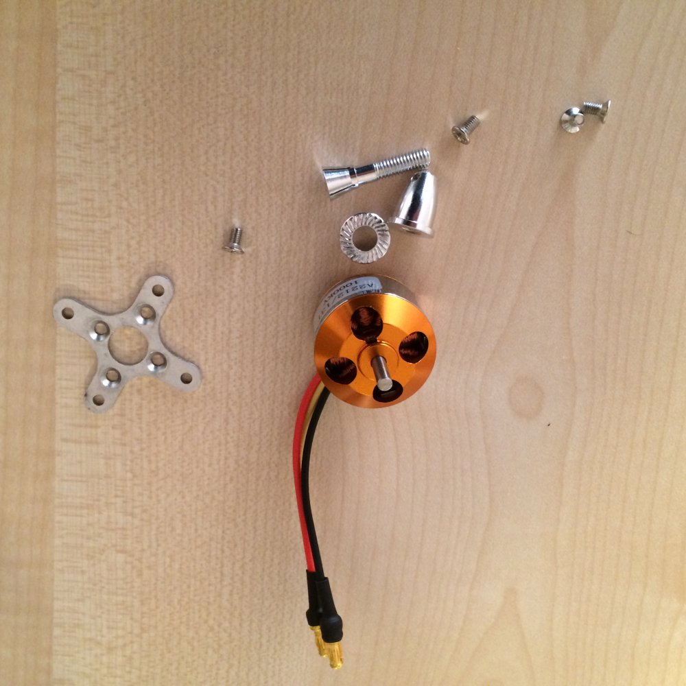

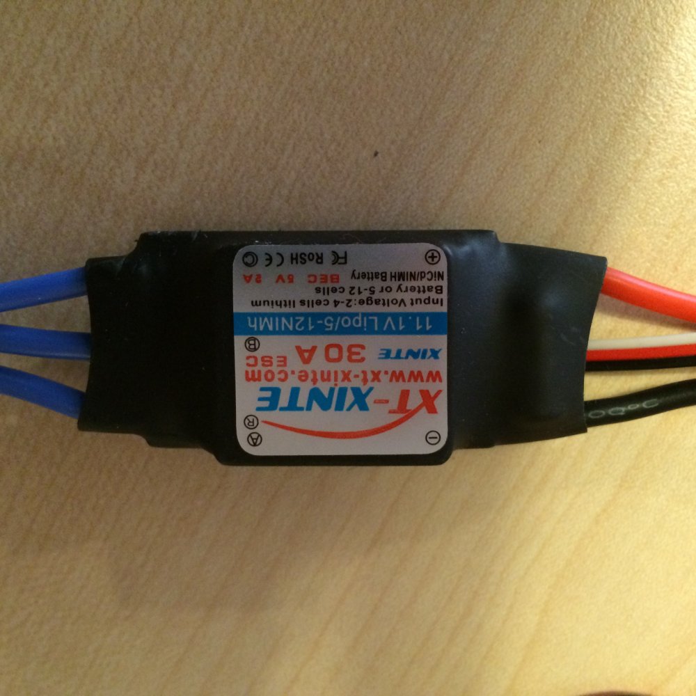

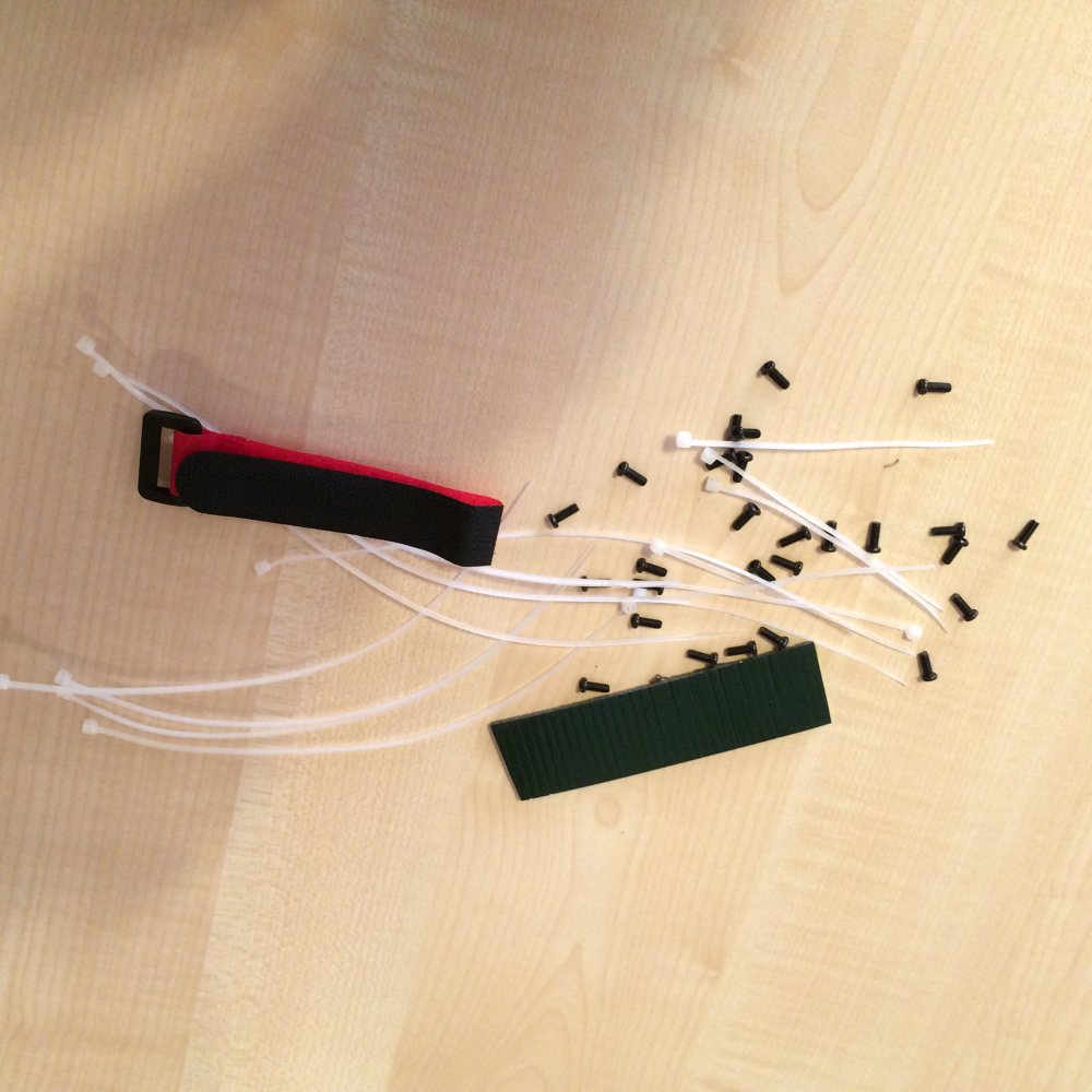

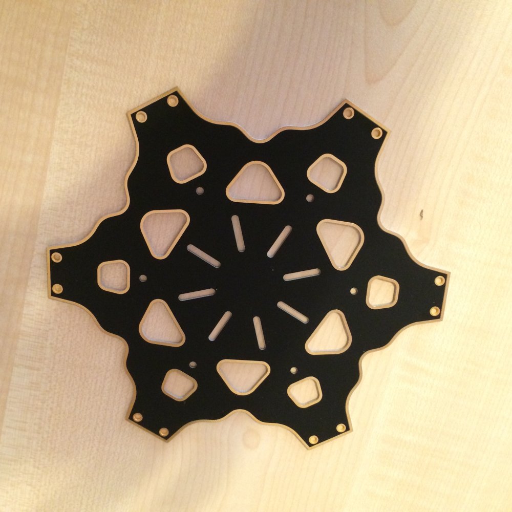

OK, so the kit has arrived from Hongkong and I am ready to take some pictures to share with you later today.
And of course keen to put it together..lol
xXLupusXx
noob but eager to learn

did the frame plate come with the ESC's already attached? what would you say is the quality of the soldering?
xXLupusXx
Yes, the ESC were attached and the soldering looks pretty solid/clean. The wires could have been aligned a bit better to the center so it would be a bit easier to fit the outriggers/legs. It is doable though.
The motors is a different issue, I cannot find the producer of these motors. Found 1 youtube video in which a guy tested the motors and their balance, tolerances etc and said they are pretty good.

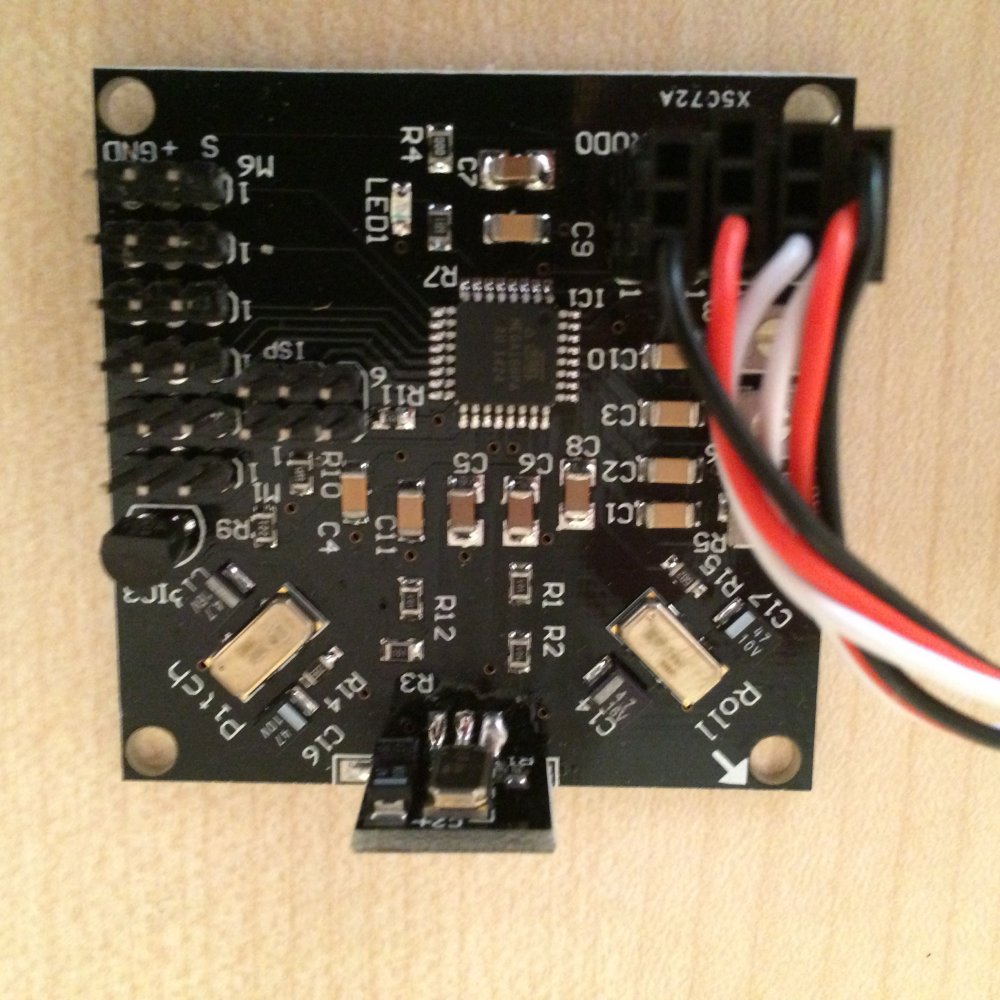

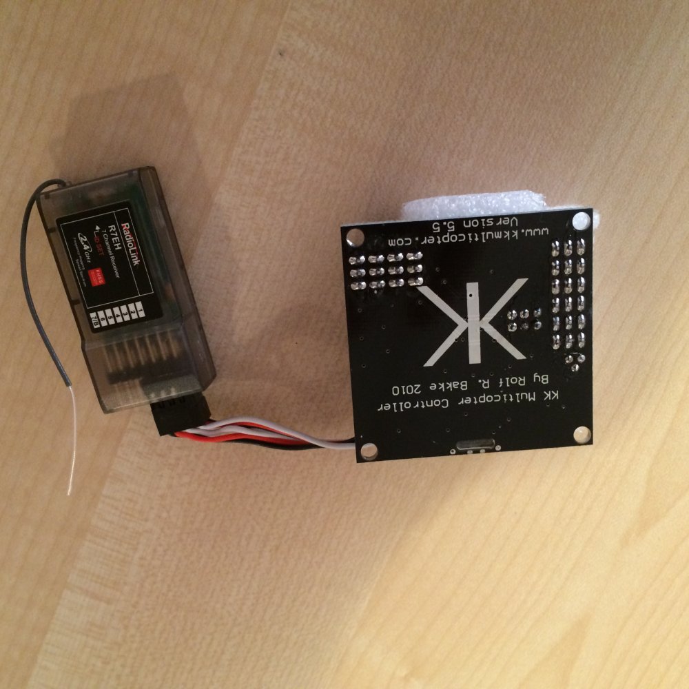

Now, is there anyone out there who has experience with this KKMulticopter Blackboard V5.5 controller ??
I would love to hear some more about it.

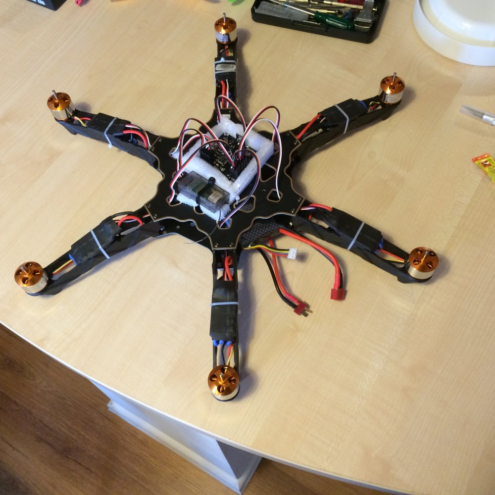

My Hexacopter is ready but cannot fly because the darned KKmulticopter controller will not arm.
Googled and found many issues, tried all suggestions but nothing works. Anyone any smart ideas? I would welcome them.
Ande here is a picture of this Totem Q450.View attachment 27427
My Hexacopter is ready but cannot fly because the darned KKmulticopter controller will not arm.[/ATTACH]
I had a similar issue previously; turned out the travel values (on the transmitter) were not completely set. Basically, when I'd attempt to ARM (pulling the stick to the lower right) it wasn't registering enough to the right. Was able to adjust the travel values and get it to ARM. This was related to the specific transmitter I was using, however may be your issue too.
Hope this helps.

Thanks mate, it might be the problem. How did you adjust the travel value ? I use a Radiolink T6EHP-E.
On my old Dynam radio, there was a knob that allowed for some fine tuning. This was an old radio that I had laying around and unsure how you would accomplish the same on a different radio.

And.....I got it working! Found a youtube movie from some Indian chaps who explained in detail how to calibrate the ESC and to arm the board. It is different than what the friggin manual says. But it works now.
I am happy and cannot wait for the weather to clear up to take her out for a spin.
