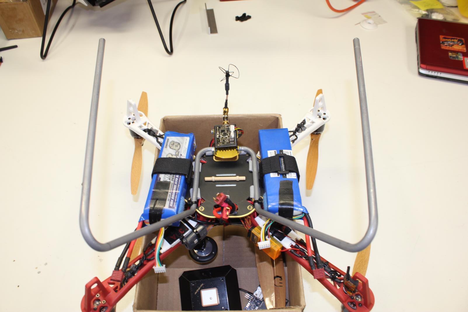

Funny you should mention that Mike. I wasn't going to use landing gear but this morning I decided to go ahead and mount an FPV camera and video transmitter to my F450 so I needed some landing gear. I had been discussing a new idea with a friend of mine and decided to give it a try. they are made from 7/16" aluminum tubing and they're a bit springy but should be fine for flying. cost, about 8 bucks for a 4 ft piece of tubing.
I might tweak the design a little but I'm happy with them for the most part.

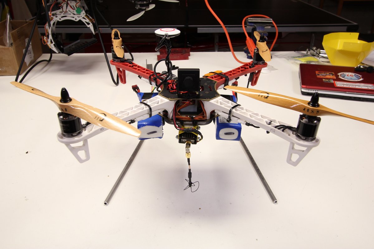

Funny you should mention that Mike. I wasn't going to use landing gear but this morning I decided to go ahead and mount an FPV camera and video transmitter to my F450 so I needed some landing gear. I had been discussing a new idea with a friend of mine and decided to give it a try. they are made from 3/8" aluminum tubing and they're a bit springy but should be fine for flying. cost, about 8 bucks for a 4 ft piece of tubing.
I might tweak the design a little but I'm happy with them for the most part. (omitted photos)
Attached to bottom plate how?
Weight?
Inquiring minds want to know!

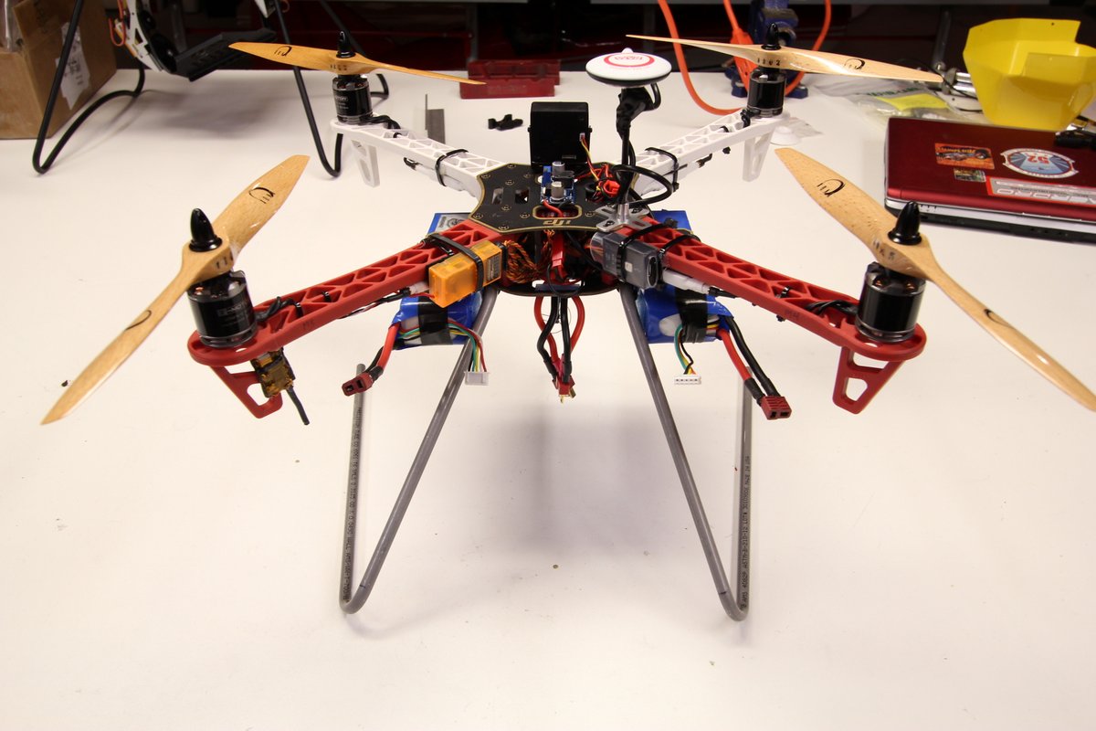

here's another pic (without the wide angle lens distorting everything)...it's held on with zip-ties and there's some foam weatherstripping tape between the frame and the tubing. i've been using this size tubing for landing gear on my larger heli's for a while so I have tooling and stuff to bend it.
weight is about 75 grams

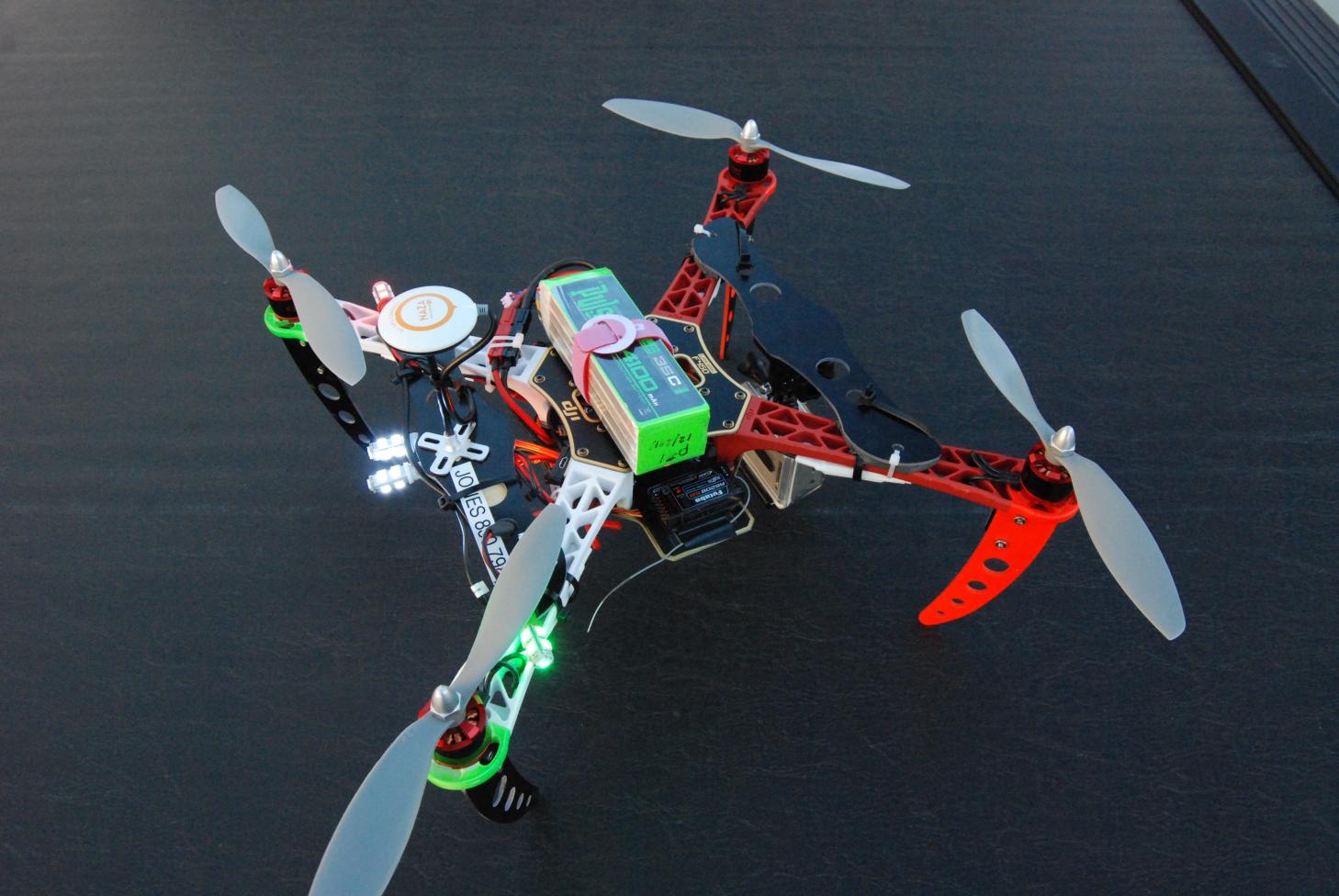

My quad is done but growing. View attachment 15851 The battery now hangs beneath the quad.
I am looking for a set of FW550 plates to move everything over to, and will be replacing the stock arms with the Aimdroix aluminum (extended length -- 50mm longer each) arms. It will then be essentially a 650. It will be built as a quad, omitting the middle two arms. Replacing the stock motors (likely tiger MT3506-25 650kv) and run 13-14" props. Will also be adding FPV camera (plus OSD and a LCD monitor instead of goggles) and a gimbal for my GoPro Hero2 (Tarot maybe?). I have the bottom plate tabs out to the sides so that I can run two batteries if I want, and I can also expand it to a hex machine if I want.
The landing gear is an open question so I hope some discussion begins. I'm looking at the Bradatech legs. The price of a good battery, but they have the ability to nicely carry dual batteries and I kinda like that.

those legs are way overpriced at $98 and they weigh twice as much as my aluminum prototype legs! ugh...maybe i should burn off 10 or 20 sets and have them anodized
Simple and light. Neat. I have a tool to bend copper pipe -- would that work?

As you see from my pic above, I got the IrisAerial legs (and painted in contrasting colors for orientation) but they really aren't tall enough. And those are batwings on my 450.
I elected to go with the IrisAerial legs.......good way for ME to keep the quad upright and still allow for a cam in the front (batwing)......
That's a perfectly good solution Mike. Lots of people are using them and they work great.
