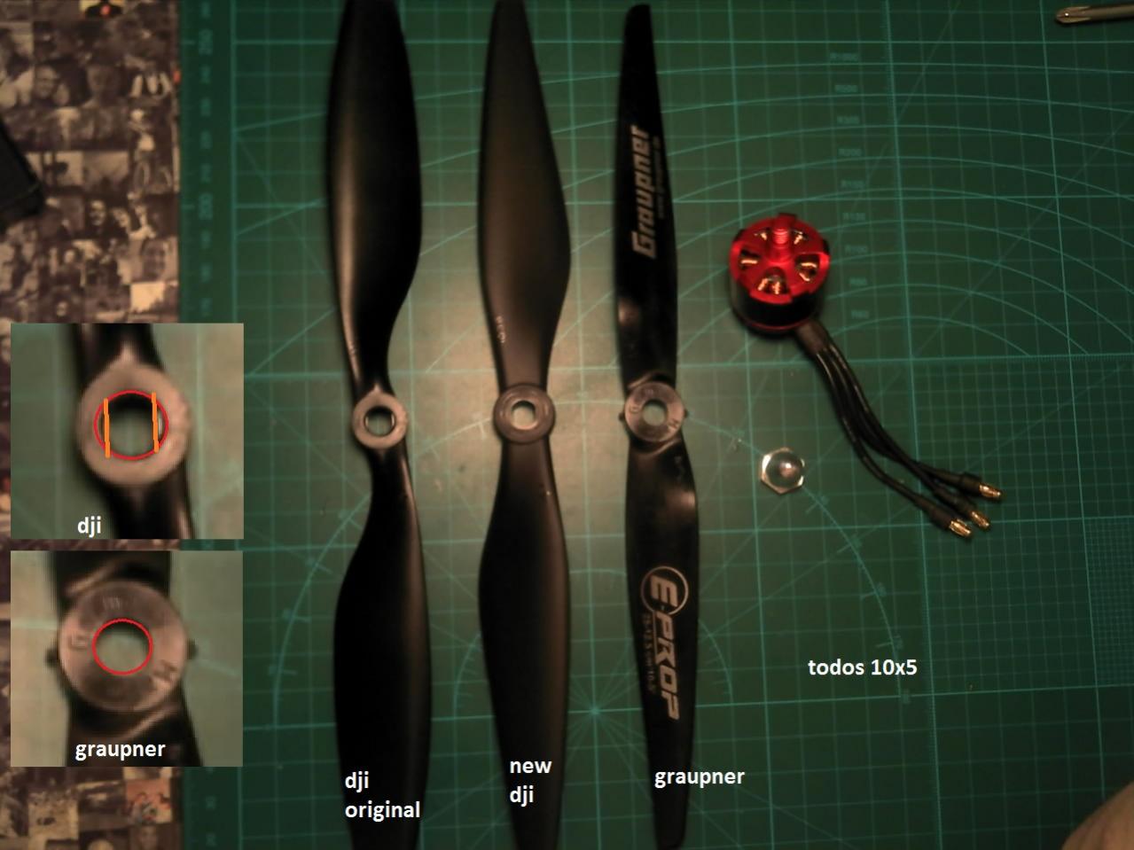

What about the graupner's central hole being all rounded? With out the grip of the dji ones.
Isn't a issue?
(a picture a took to show what I mean)
It doesn't make graupners turn blind easily?
Do you guys use some kind of glue on the prop to help?
(sorry for my bad english)

I dont use them on DJI motors but I never use glue.. Just tighten them up correctly, you do have a plate washer under the spinner I take it?

Actually i'm not even flying yet. I'm just concerned about the best way to use these props on dji motors. (making some home test here only using my hand I thought the graupners was easier to turn around blind)
But I belive it is better to use a washer between prop and nut, so I don't risk to unbalance the all thing. Am I wrong?

I just put the Graupners on with the stock DJI nut and tighten it so it is firm. No washers here. Works fine but I only have about an hour on them so far.
that key makes it a nightmare to deal with balancers. regular round prop holes work fine but it takes washers to do it with a dji motor.... i think it's a 6mm washer for each motor. no glue, just tighten and fly
