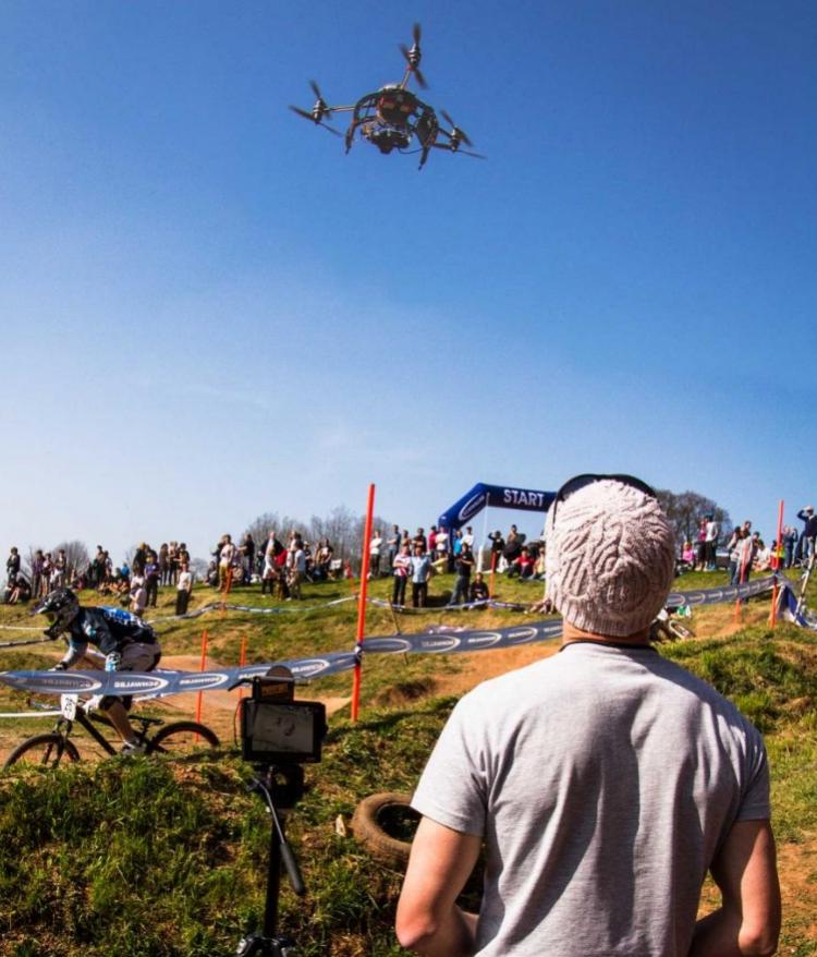

We use a 7 inch Lilliput field monitor with a 5.8Ghz Rx/Tx link. Has a built in battery that will last several hours and the screen can be seen in bright sunlight conditions. Very portable and comes with a tripod screw so tou can mount it on a tripod or elsewhere.
Do a Google search for them, in the UK they're about £150.
