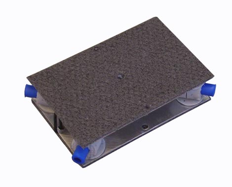

I have succsesfully dampend the vibration from the craft to the camera with this device. Bought on ebay search for "anti vaibration #300".
It can be mounted upside down and has a limit of 240grams. The gimbal and hero2 are 235grams.
Here's a video of the test with iSeismometer on the iPhone,
I will mount this under the fixed camera mount plate.
Will do some more testing when the fixed camera-mount arrives.
Also received the Graupners, there perfect in balance.
I wonder what material they are made of. If we known it might be easy to make one that doesn't way as much.
the dampner between it looks just like ear plugs. the ear plug dampners work awesome, couple bucks to make, doesn't need the board, but they make it easier to attach like this
cause the rubber band doesn't touch the base
this works really good to, but the rubber band tension versus the camera moving around is alot more touchy. too tight is simple, makes it like nothing is between them, too loose and it's a great view but the camera shifts, falls out, but there is a just right in there.
my last video was that setup but the rubber bands got looser and more of them now, i use 3 bands, cut and tied em for the right length
