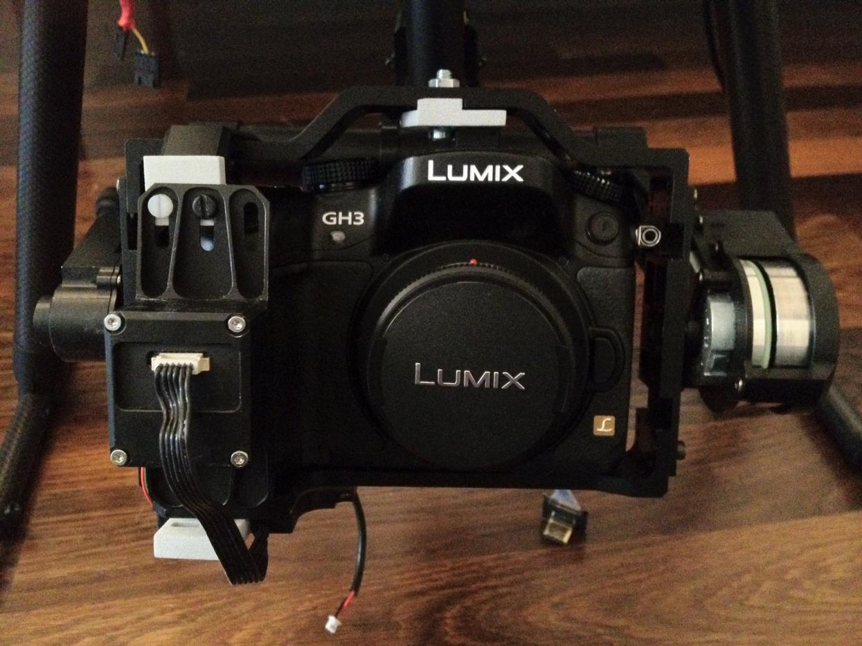

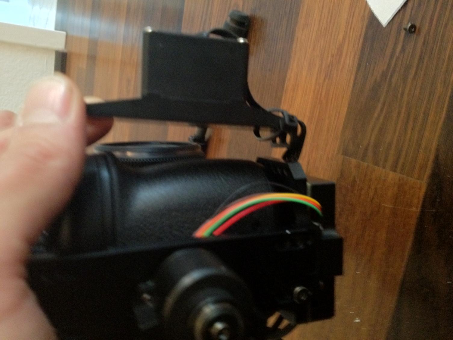

Bibills, I will show you guys once I really see that it makes sense. Just talking to a 3d Printer guy who will make me a prototype of the adapters I made.
At the moment it looks like two little parts are enough to extend one part (front sensor bar) of the Z15 and a little adapter shoe to fixate the CAM.
Lucikly no parts are needed to rebalance the GH3 but certain areas are quite tight.
If everything works out with the 3D program thus file i just sent the guy it would be finished by friday. Little different approach preparing files for a 3D printer etc.
uh the guy is fast, just got the okay.

looking good to far have a solid lock of the camera in the zenmuse frame ! Receiving changed part again tomorrow. But it looks like gonna fly it on sunday.
Only going to fixate it on the top:
Hope it won't be a problem some handles also just attach on the hot shoe: 1:40

hexa
Looking great.
From the demo footage I have seen and the cam specs seems the gh3 paired with the z15 is going to be the ultimate tool for 2013.
Is there enough room for camera trigger plug to be plugged in ?
BorisS
The original doesn't fit. One has to cut the old one and solder on a new plug without casing. Even shorten the naked plug on the back side were you would solder the single wires. Just keep the GND and first signal the rest clip of. I than hot glued around the solder and covered it with liquid tape.
The remote port on the gh3 is on the otherside of the camera compared to the gh2. So the cable has to shortened all together.
Boris

to tell the truth i don't think they will be offering a kit. The more i am fiddling with it the more i am noticing that there are to many little compromises.
1. Remote plug has to be redesigned
2. HMDI rubber cover is a ***** to flip forward and keep it there to get the camera in.
3. Sensore bar has to be extend forward otherwise not chance to get the GH3 in balance on the nick/pitch axis.
4. Having it balanced in roll one of the ears for the camera belt is touching the Z15 frame.
5. I don't think even if they change parts that it will be an easy slip in of the camera as it is with the GH2. The user will have to do a little more than just tightening two screws.
And other hassles i can't remember at the moment.
It is doable with little changes and the will to balance the cam every time you stick it in 10 mins maybe or less depends. For the engineers at DJI it roll axis and the given space on it won't be enough. The won't make a half hearted mod.
