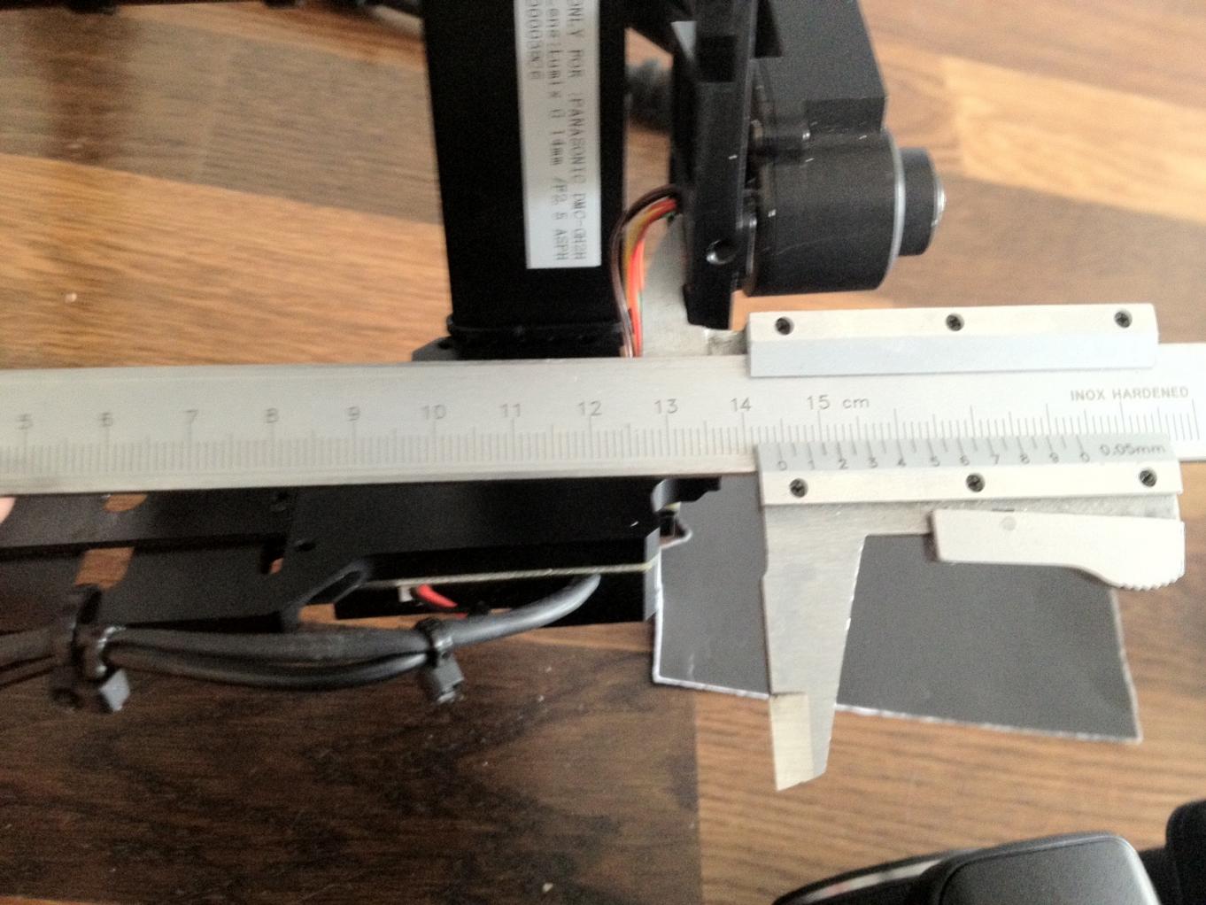

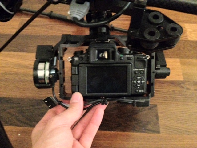

Squeezing it in should not the the problem. In the worst case I have to get the bottom plate of the zenmuse new draw it reposition the hole for mounting the GH3 and send it to a cnc guy. Height wise the zenmuse has enough reserves it can be widened, screws can be loosened the the top bottom brackets pulled apart.

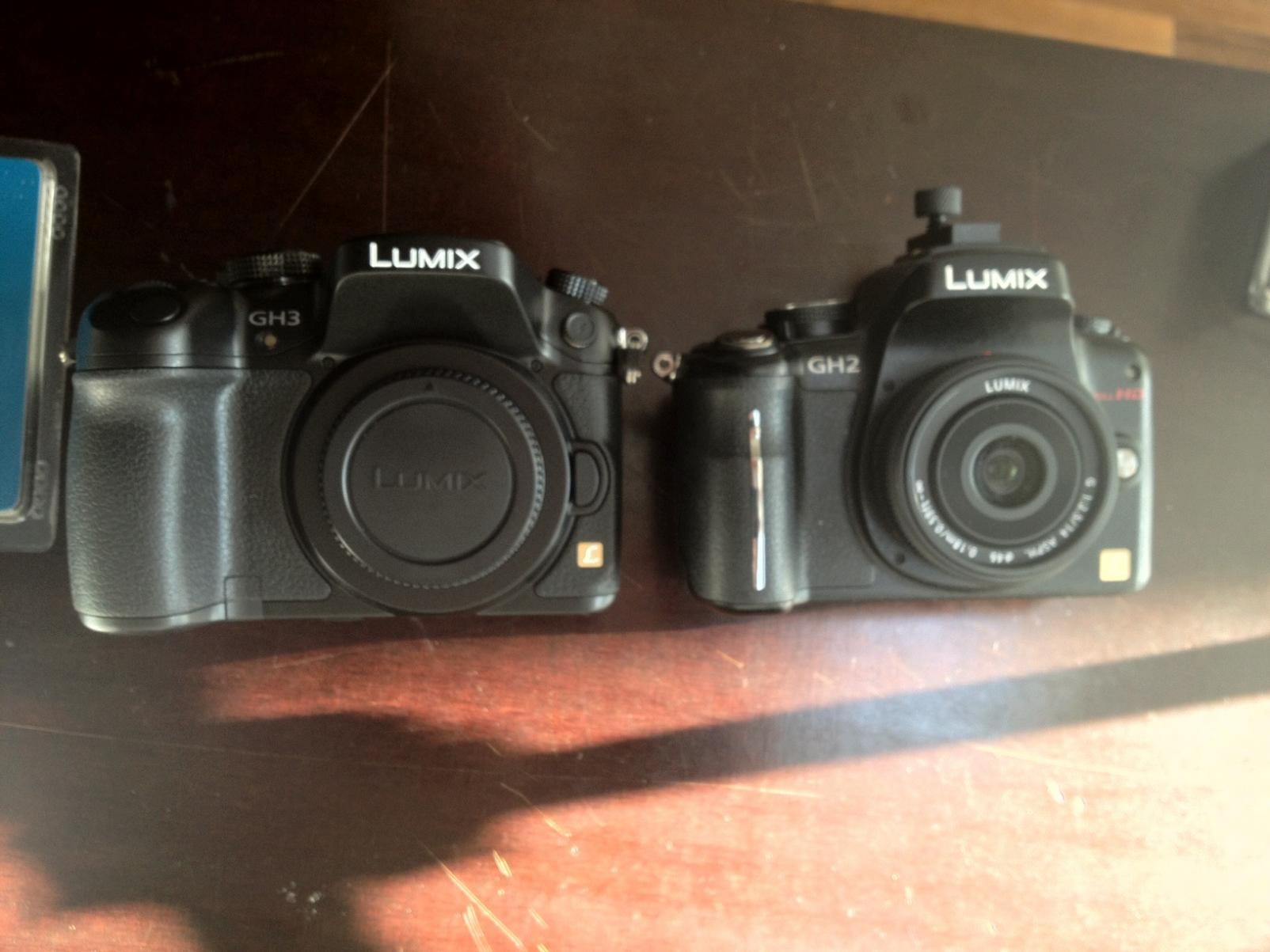

size of the GH3
adjustable height
I am not sure though if the camera dimension are including the little metal holders for the camera belt or what ever you call it. These could be a problem
The Question is if the motors will take the extra weight of the gh3 lets see. And i am worried about the HDMI converted that it works with the GH3. But i am hoping that the Gh3 also has AV out live than it should be possible to link it to the analog signal after the HDMI converter. Yellow black cable going into the first motor on the pitch axis pretty sure thats analog and the video signal and GND.

Japp it fit width wise even with belt ears thingis already check and height it also no issue. The problem is the hand grip on the GH3 which is longer than on the gh2. Which leaves the GH3 completely unbalanced on the pitch axis. Already the AD program creating two little extensions and will bring it to the laser cutter. Just not sure because the part that gets extended i think has the pitch axis sensor on it. The question is if the zen has an issue if the sensors gyros whatever they are get replaced, even if everything stays in balance.
