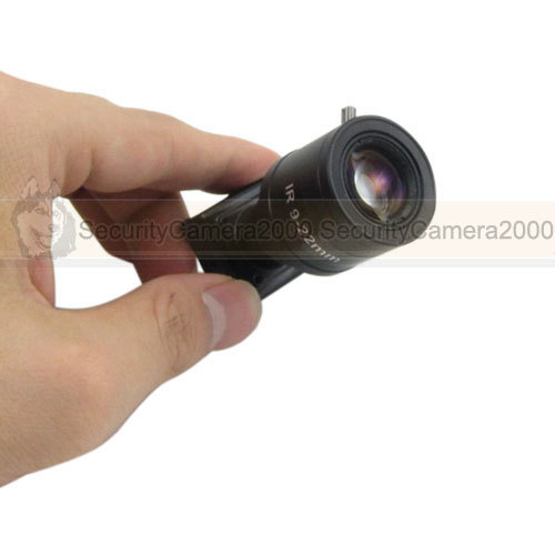

Personally I dont like wide angle lenses for flying but I do for recording. I use 2 separate cameras, Go Pro knock off for recording and a 650TVL camera for flying. Wide angle lenses make "objects in your lens look closer than they appear" if you remember reading that on your car mirrors. They warp your view and it makes it hard to see where you are going exactly or get a good idea of how far away things are. Too much wide angle and you're flying in a fish bowl and you can't see if you are tilting down slightly or flat etc. I use a variable focus lens that allows me to use 2mm to 14mm and focus accordingly so I dial mine in the way I like it which is almost normal vision with a slight amount of wide angle for a better view.
