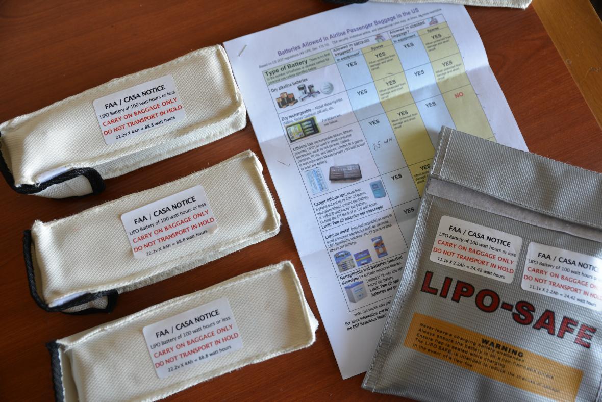

Here's what I did when traveling to the US from Australia and on domestic flights in the US. Worked great. They looked at the label and said, 'Fine'. Needless to say, the labels were self printed (well, actually they were printed by a fellow forum member who will be traveling internationally tomorrow).

Great ! But does the "do not transport in hold" mean not to be carried in the cargo bay ?

That is correct. I fly domestically in the US often. When I travel with my Phantom, the lipos reside in the case. If I am traveling with another copter and regular lipos, I just travel with them in my backpack. I do take them out when going through security. I do not tape the XT60 connectors or put them in separate lipo bags.

That sheet of information in the photo is the FAA regulations. I carried the regulations with me as you'd be surprised how many TSA agents aren't clear about them. Those regulations prohibit lipo batteries from being transported in the hold. My copter was in a Pelican case and it was opened twice by the TSA for inspection. I suspect if you put lipos in your luggage there's a good chance they will be removed if the case is inspected.
