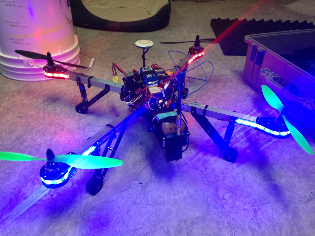

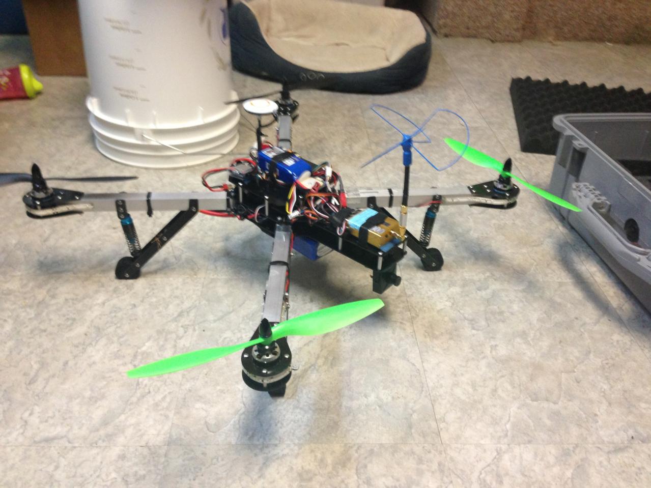

I am thinking of changing my heavy next level quad to either the qav500 or tbs-d . I was wondering if you could input on which frame would you think best fit a direct transfer? Keeping with a 4s-5000 lipo setup
Here's what I have...
I have been flying my Next level 650 Quad fully loaded with ..
-Skylarks Trace OSD,
-sony CCD 600tvl camera
-Dj Naza M V2
-futaba 13ch Sbus Rx
-800mw 1.3ghz Vtx .
- 4 x Iflight 880KV (2217Q (22mm)) motors with 10X4.7 gem fans.
-4 x 30amp Inov8tive ESC w/simotech firmware.
-I'm using a 3s 1000mah to power the VTX and camera . and a 4S 5000mah for
flight power.
The frame alone weighs in at about 20(not including shocks and camera
extension front mount) Fully built and loaded She weighs in at 5.76lbs
I am hoping to improve flight time by using a lighter frame

So Which would you choose for me? lol I have been looking at both the QAV, and now the TBS Discovery. The only thing about the discovery is that I dont think I need the build in PDB, or trace links on the board. I use a S-bus RX so its only one wire connection to my NAZA. I've also been looking at HoverThings, and chatting with them. The HT-FPV wont Ballance right with a 4s-5000mah. So I may be stuck with their HT-450/550. Which is just the plane old "X" shape quad. Was hoping to get one of the cool "H" shape frames. The QAV, I hear shatters like glass....? But most importantly, It cost alot, and parts are expensive.
Here is a pic of my flying tank.
