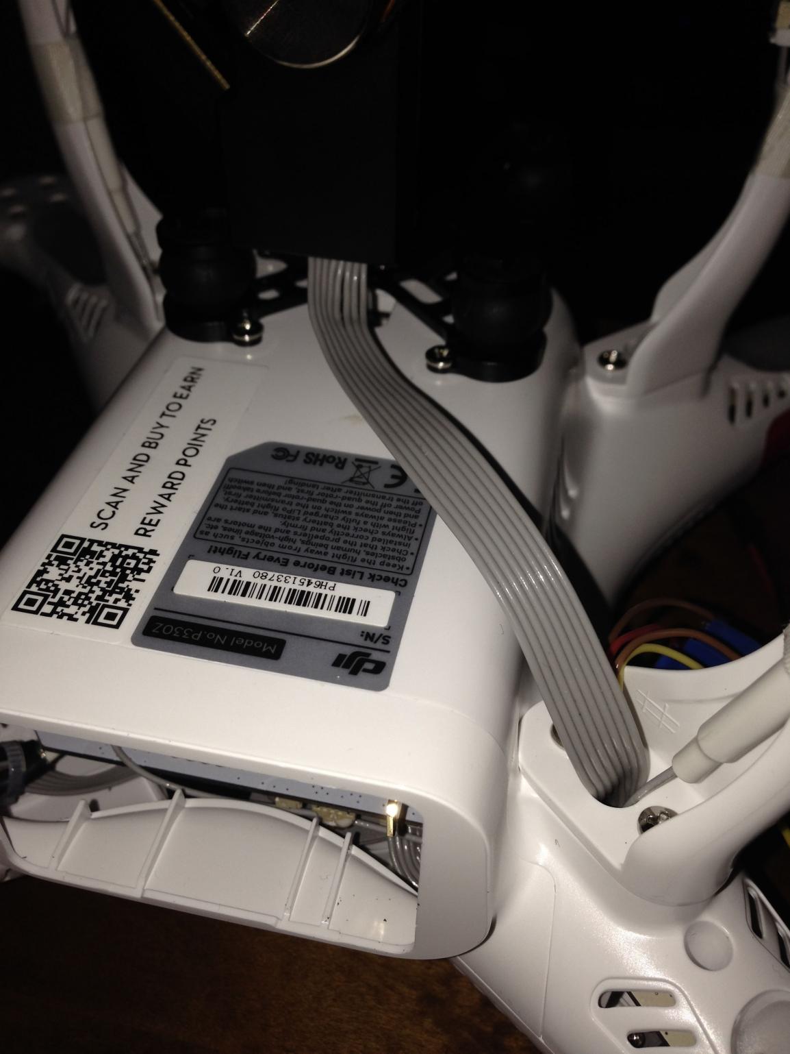

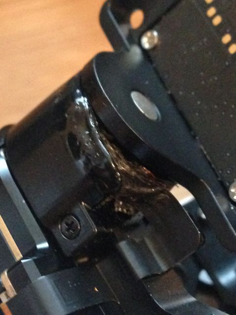

The gimbal on my P2 has just blew up, iv done nothing different, its literally the 4th time iv turned the P2 on, camera plugged into gimbal, screwed in, transmitter wired in properly, P2 battery in and as soon as switched on, the gimbal started smoking and flames appeared, I've sh*t myself and instantly blew it and pulled the battery in a split second, some plastic has melted and deco burnt it out??? I've took the camera out incase it was something to do with that, gently put the battery back in again, turned on, and again smoke and crackling noise, iv near vomitted, paced the floor, and shouted at the dog! me head is battered! it was fine yesterday, no problems at, flying, transmitter and fpv working, it was fine.
I know nobody would of had the same problems but can any one maybe tell me what it might of been, or where to go now etc, a friend has brought his P2 round to mine, and i could possibly fit his gimbal on mine to see what happens, but i don't know what to do
Im a total newbie so any possible technical answers, please explain clearly, thanks

Just from what you described and the pictures, I would say that there was a short circuit in one of the servos. Poor manufacturing and/or QC at the factory - probably a wire that was knicked or had a poor solder connection. Vibration during your last use could have caused a wire to pop loose, causing a short. I would say this falls under warranty provided you haven't had it that long.
Alas, once the mystical smoke is allowed to escape, you're pretty much done.
if it was purchased from a reputable dealer then you shouldn't have any problems getting a replacement. whatever you do, don't reconnect the power with the gimbal connected! :)

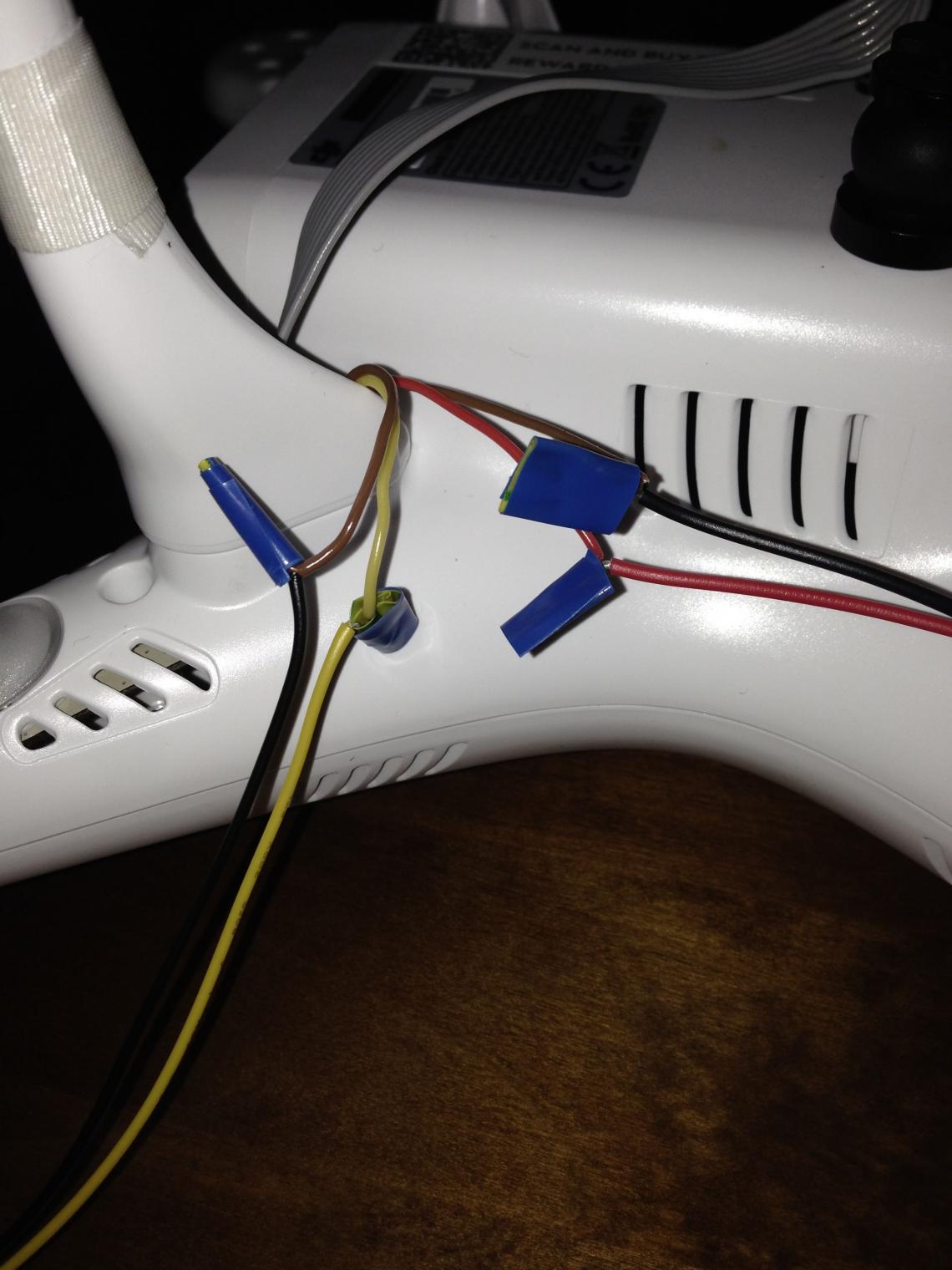

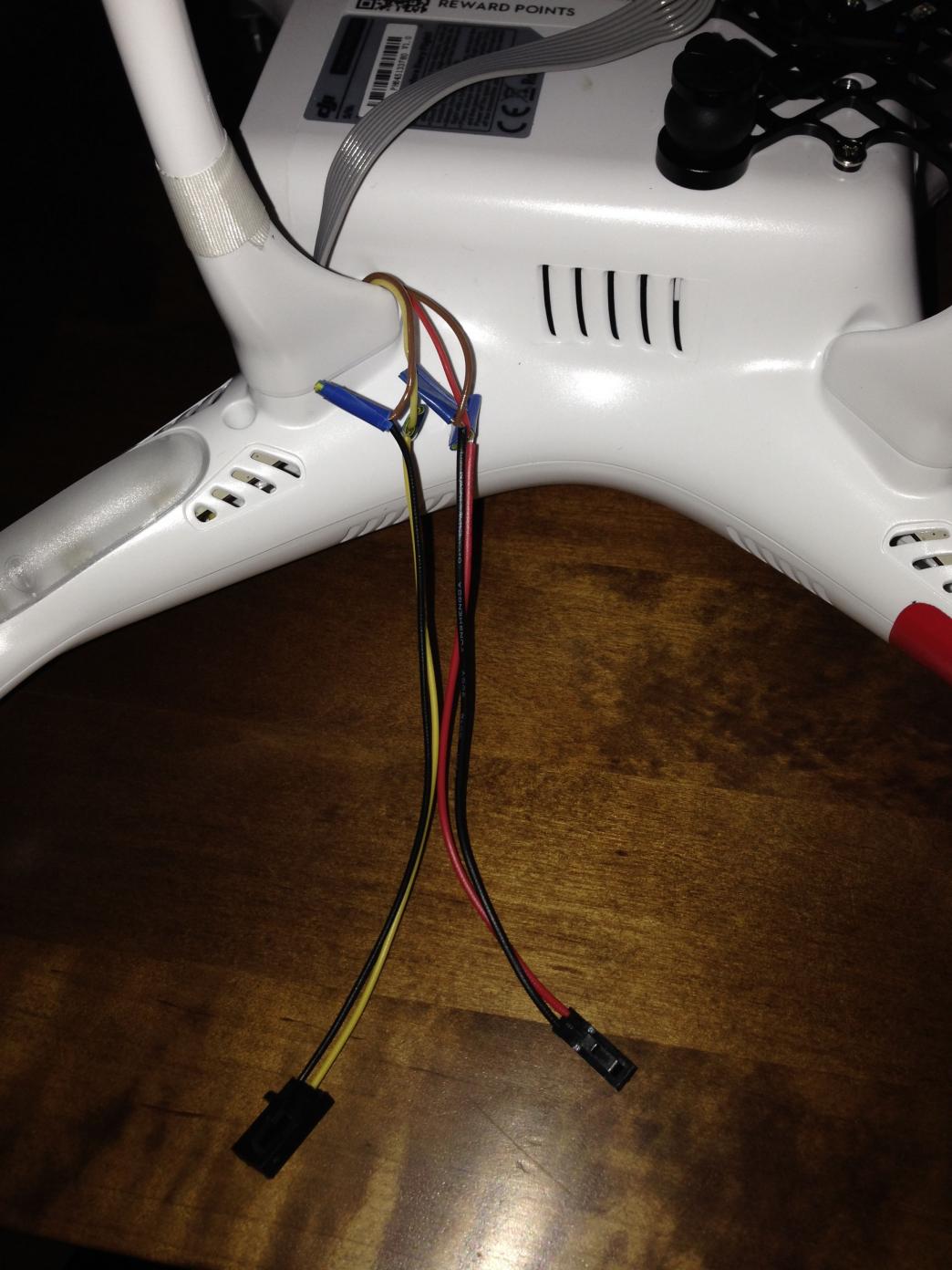

I guess it really depends on how the Phantom is wired to the gimbal. Theoretically, it should be in parallel as far as power goes so even if the transmitter draws more current, it shouldn't have any effect on the Gimbal.
Tahoe Ed
The vTx does not power back to the GCU. There are other issues in your set up. I use the Immersion 600mw and the DJI vTx neither have cause that problem with either of my two H3-2D's have experienced your issues.

some pics...

the wires have been soldered, then covered twice with insulation tape, loosely zip tied and tidied up etc, I've took zip ties of for the pics, and bear in mind that its been working fine with the first 200mw transmitter.. thanks
