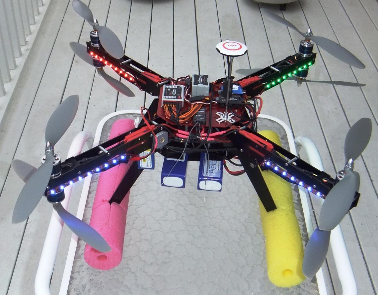

Gary, where is your GPS mounted? I have mine mounted on my boom as far from the FC as possible, and when I change batteries, it picks up GPS again in a matter of 10 or 20 seconds.
Gunter.
I have mine bolted to the back right corner, and I'm using the longest of the three rods provided. I'm not sure on this particular setup if I can get it any farther away. :)
-- Gary
