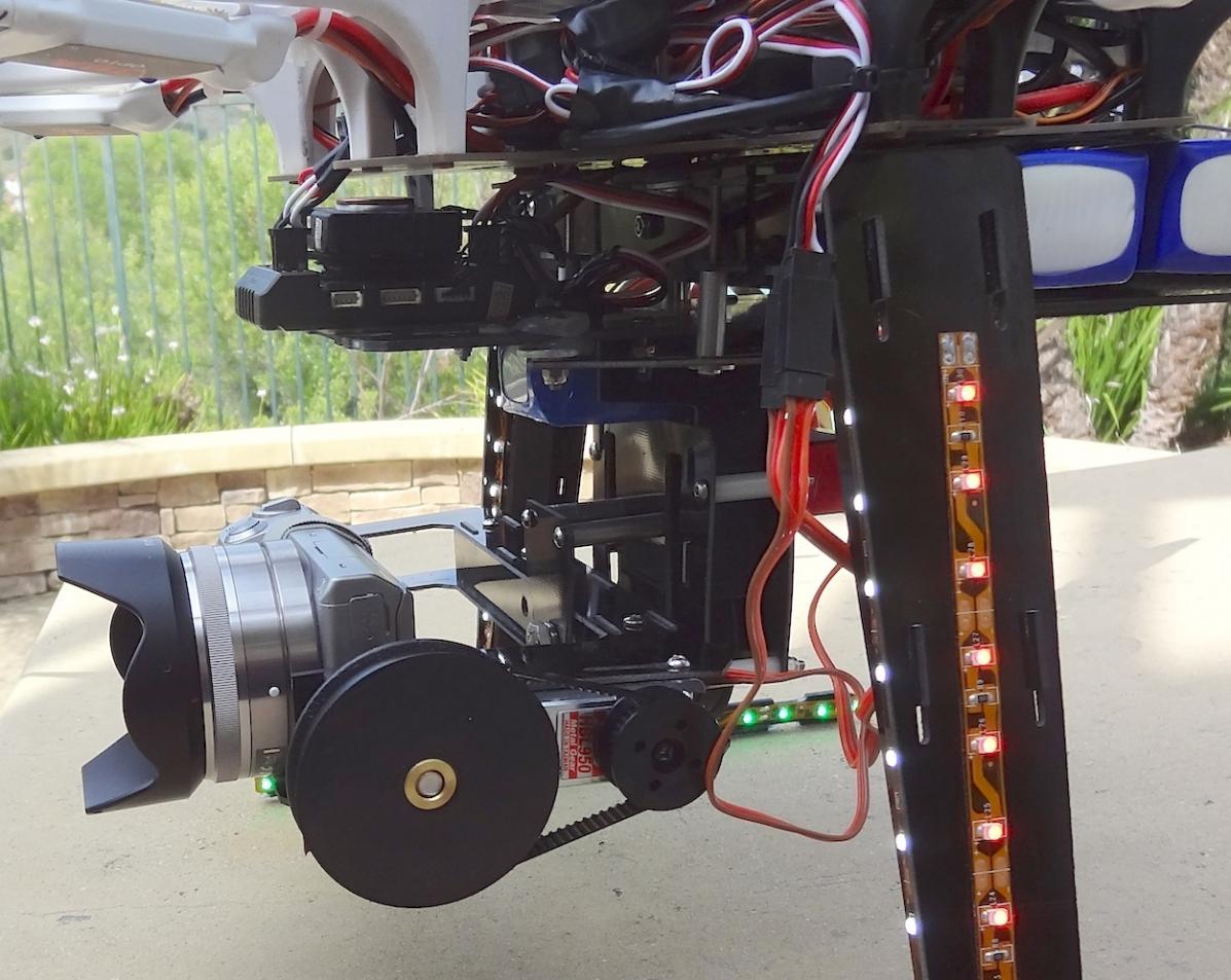

Sorry about not responding sooner. The gimbal Chris is using, is one of the prototypes of a new 2-axis gimbal that is sized to fit a DJI F550 and has a yoke the is tailored for a Sony NEX-5N/7. I am developing this gimbal with my partner, Andrey Kim (Askman here...). We are close to releasing this gimbal and just have some final "tuning" to go on a dedicated gimbal controller that we will make available as an option.
We are happy with the operation and performance of the gimbal itself now, and have made some small changes and "tweaks" since the earlier versions like Chris' unit. We are now using two MKS BLS950 high resolution brushless digital servos, with 2.5:1 belt drive ratios. In order to really get the most out of this gimbal, you need to use something other than WK-M or Naza's gimbal outputs, which are flawed, in my opinion (slow 50-100Hz update rate, vs the 400-500Hz required to allow smooth movements...). On my own setup I have been using an XA v1 FC/AHRS combo as a separate gimbal controller, and it works quite well, but what we are testing now is using a small Naze32 board with some special "tuned" firmware. We are probably one update away from finishing this testing effort. Once complete, we believe we will have a total package with real "Zenmuse-like" platform independence.

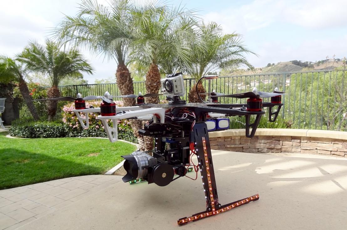

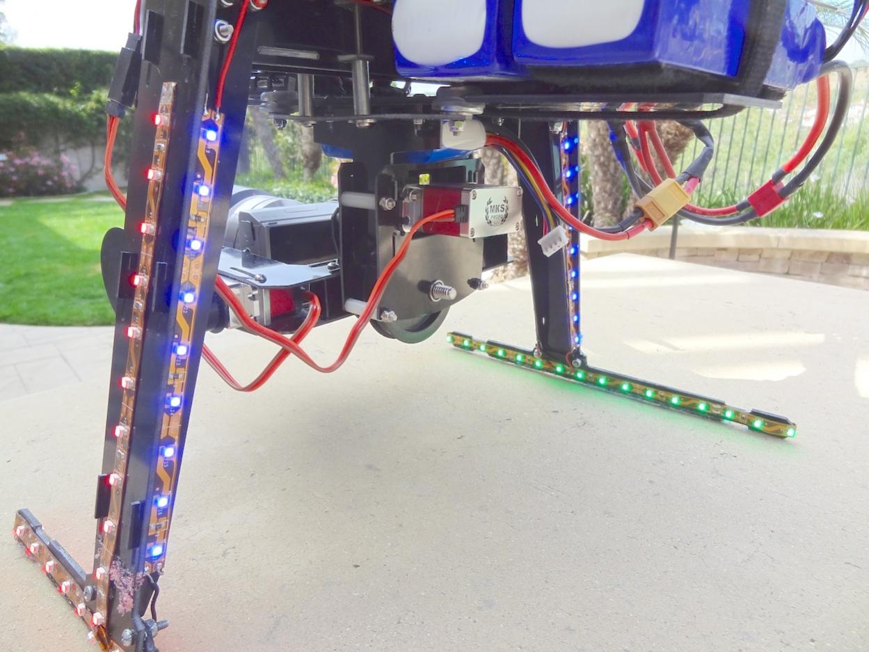

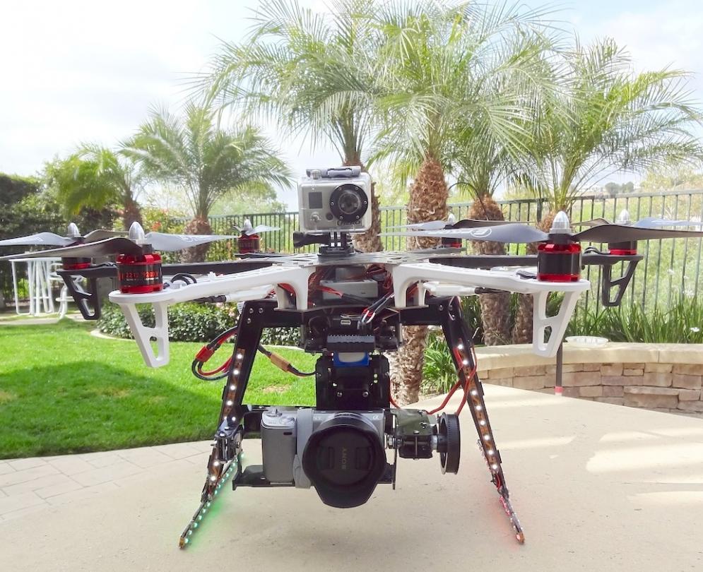

These gimbals will be available at a number of sites, once we get production ramped up. Initially, however, they will be available at my TPpacks.com site, which I'm in the process of revamping. Right now there is just a placeholder store front, but this will be updated this week to have more info about the gimbals, etc. Attached are a couple pics of the TP550-NX mount/gimbal. It includes the integrated landing gear (but not the LED strips which I added to help with orientation...).
We also have a smaller GoPro version that is sized for a F450, and versions that are tilt-only and isolation-only. We are also going the other direction and will have a larger DSLR-sized version.
More later...
-- Gary
