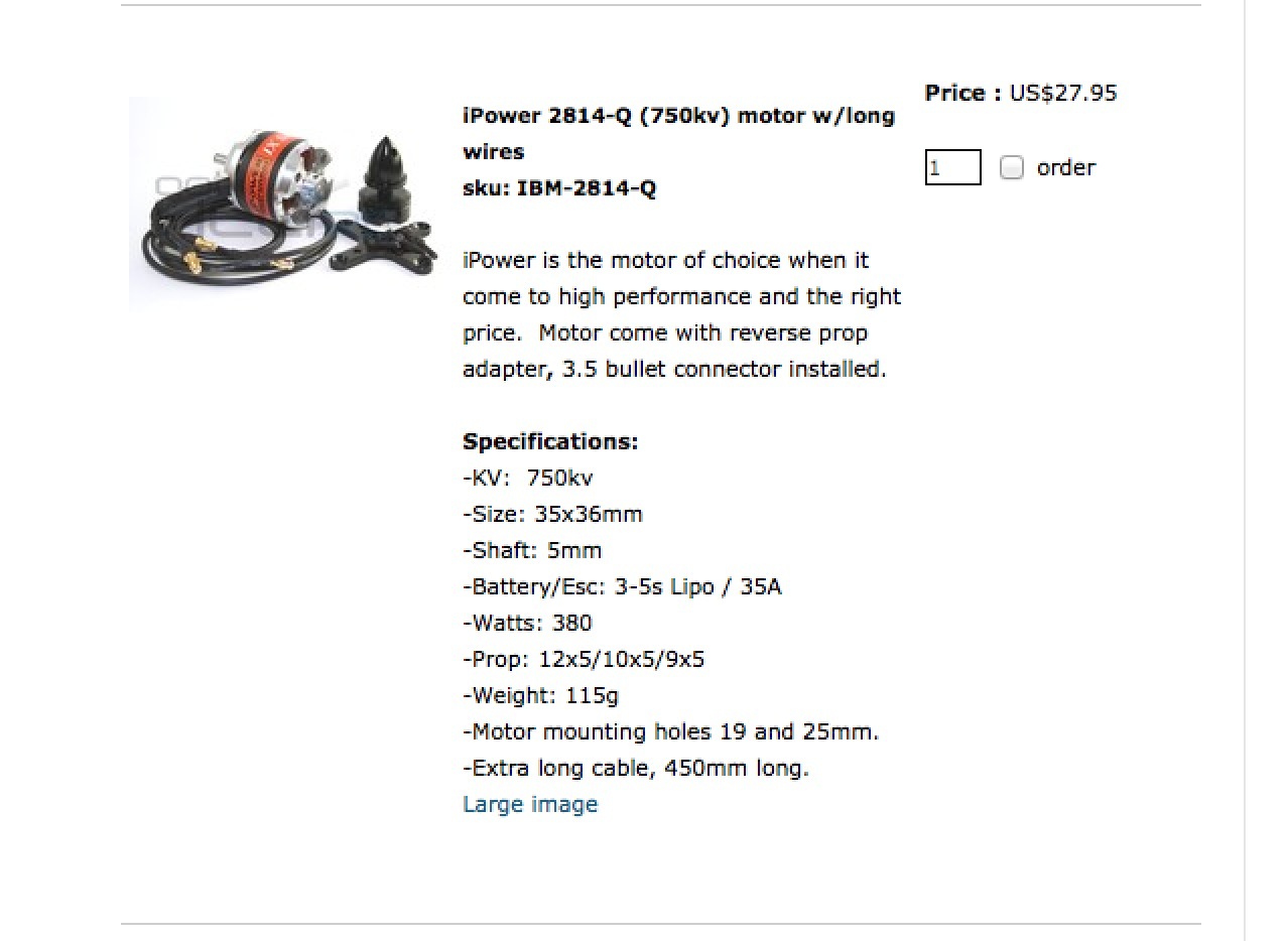

Lou at GotheliRC on here has a good option at this level, there here
http://gothelirc.com/shopdisplayproducts.asp?id=135&cat=iPower
bottom motor on that page. I've been trying to try those, but have had such good luck i'm afraid of change.... Last time "change" happened in America i didn't like it a whole lot
the ones i linked are rated to 380 watts and 5s, there also multi rotor purposed in the hub that comes with it is ready to rock and roll, wires are long if ya wanted em, these all come with the bullets needing soldring on so you cut the wires where you want, etc.
My money would do either the ipower or the suppo...... but that's me. The suppo are 4s and 350 watt. This stuff your posting are twice the size and half the power.

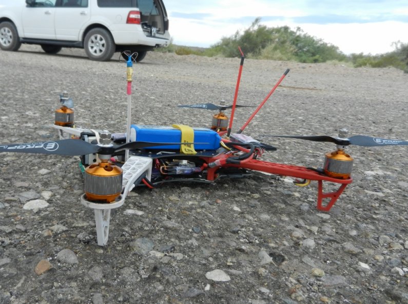

suppo are super tough, I learned 3d on onemotor, probably crashed it 300 times, hard....... still flies, doesn't get hot. litteraly 500 flights, crashed every time. I go flying with a pocket of props. The plane doesn't care, change the prop and fly, crash, repeat
F450
Do I have solder the suppos? I really don't have much experience with soldering, can I purchase ones with short wires already made to go? I'm just using the stock dji F450 frame and motors, don't need long wires.
for sure garunteed you do on the suppos. I've bought 15+ of those in the last year.......... I sent lou a message to come tell us how bad he wants to sell a set of ipower motors. The suppo guy is around here too, we can ask him as well if you want.

the last pic you posted was the 2814,,,,, the 2810 are like 4mm shorter in the chrome part. more a pancake looking thing
I sent them both pms, we'll see who wants to sell em to ya. I think Alttitude hobby has the ipower as well.

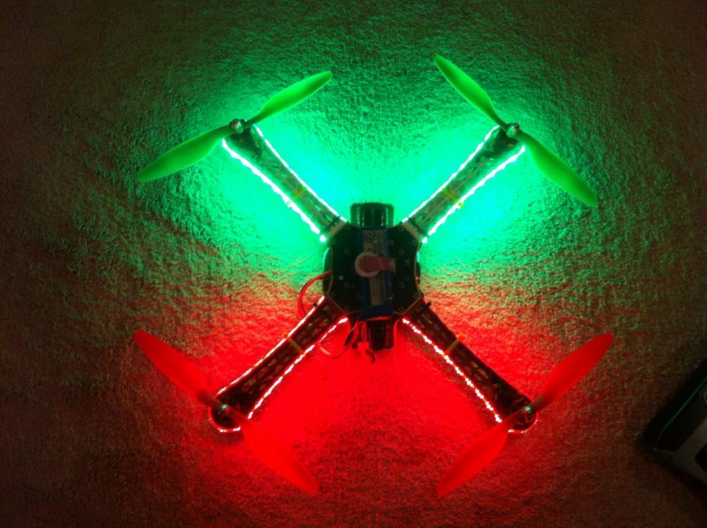

Did you paint yours green in that pic? I'm going to fly 3S for now, but maybe go to 4S later. I really like the suppos, you did mention you get over 50mph with them if I can remember :)
yea, that disco gold and chrome got old. They were black but the particular black didn't take to the self etching primer you see. That plasti dip stuff........ when i use base coat like for a car it's golden. This is then 2814 painted up....... 60mph in atti 4s 8" and 2814's
