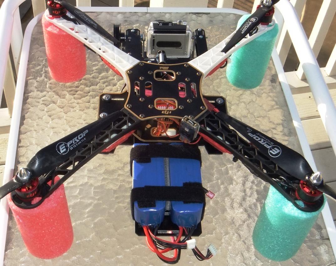

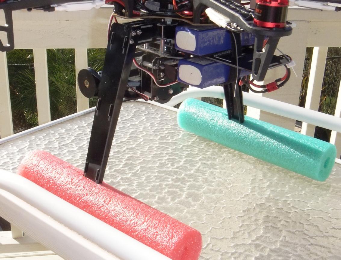

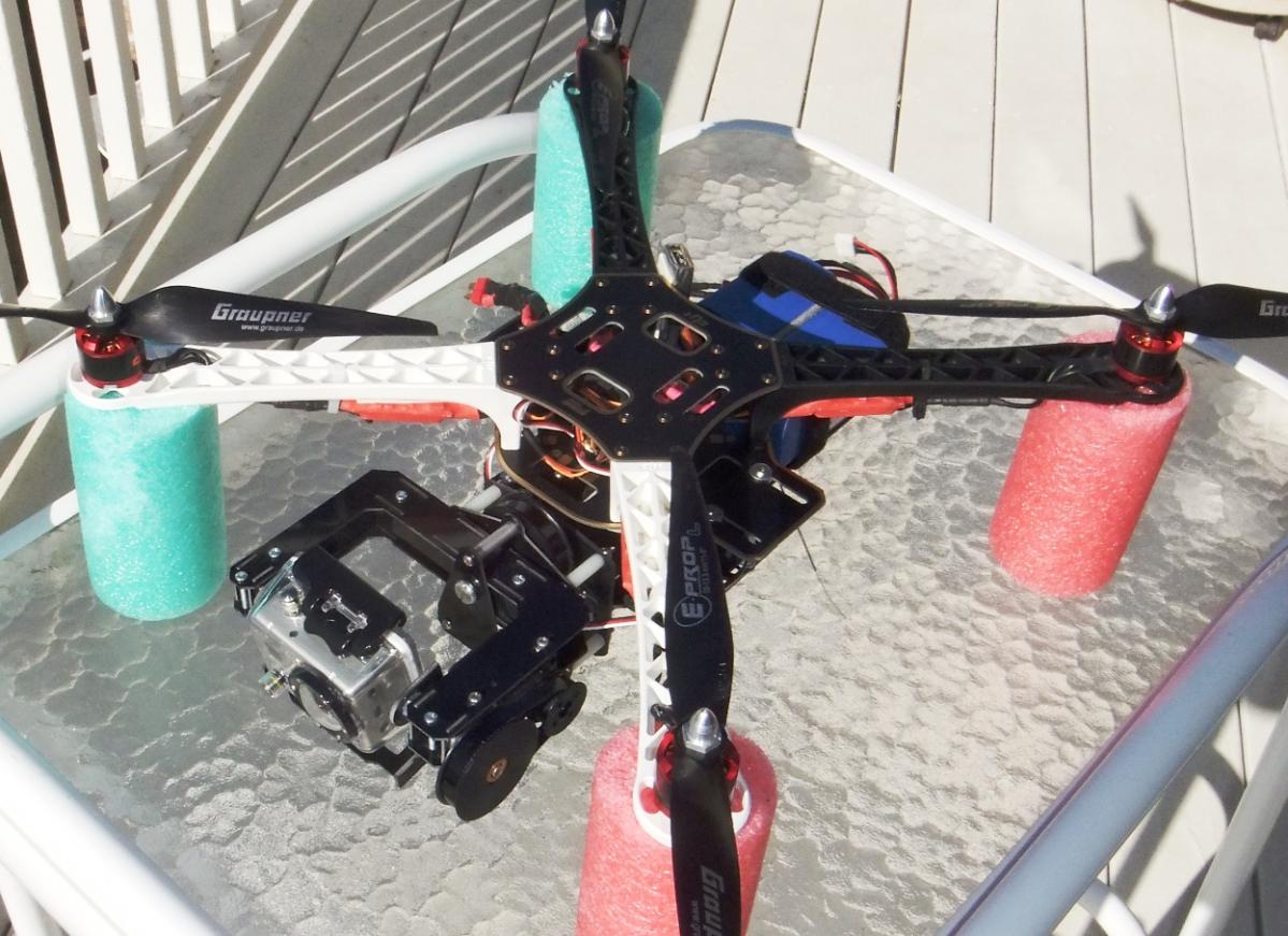

Where can I find more info about the "TP GoPro mounts" that you will sell?

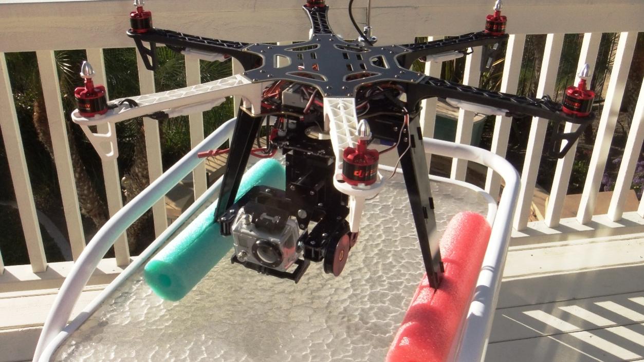

Hi Benjamin --
I'm still in the process of updating my website, but the hope is that it will be ready-to-go in a few days. There are two versions of the GoPro gimbal/mount that will be available, one that is tailored to fit the the F450 quad, mounted on the front in an "inline" fashion, and another that hangs underneath an integrated set of landing gear on the new F550 hex. Both are 2-axis, belt driven gimbals, and both use full-size, high-speed, high resolution 12-bit digital servos that are specially programmed to have a full 180 degrees of motion, and to have the deadband space "tuned" to the WK-M/Naza's gimbal outputs.
The gimbals are actually identical, for both variants, and use the same mounting plate/battery tray. The roll axis assembly simply mounts on the front, for the F450, and mounts underneath in the middle, on the F550 hex setup.
The video below is a demo of the hex setup, which I just finished tuning.
I'll post something similar with the F450 version, in the next few days, along with some new flight videos.
-- Gary

Gary, I really like the gimbal! What ballpark are you shooting for cost wise?
The TP450-GP, which is the F450 GoPro gimbal/mount will be $375. This includes the specially programmed servos, and will be mostly assembled. We break it down to major assemblies, for easier shipping. The TP550-GP is the F550 hex version, and it will be $475, the difference mainly being the custom landing gear with skids.
There will also be the TP550-NX version which has a yoke sized to fit a Sony NEX-5N/7, a Panasonic GH2 or a Canon T2i/550D, that will be $500.
All will be available starting this week at my site, TPpacks.com, and via Robert's DJIUSA site.
-- Gary

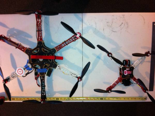

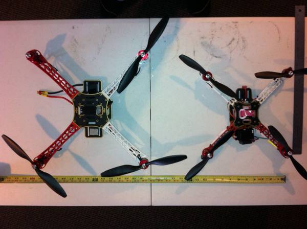

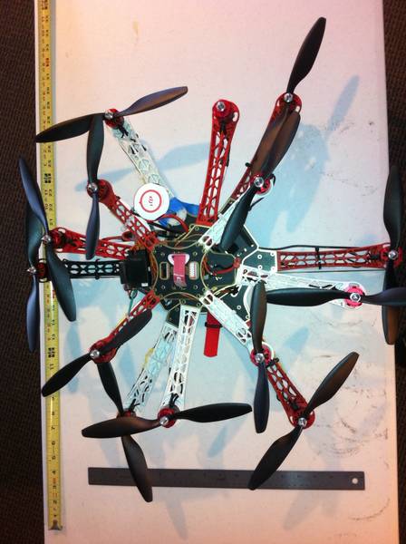

I stand corrected. :) They did ship kits to dealers last week. We just have two samples but I think there are more coming with the F550 order this week.
I'll take some quick iPhone pics of the f450 and f330. Its very small. Fun for indoor stuff.
UAVproducts
Formerly DJIUSA
Sorry for low quality pics
