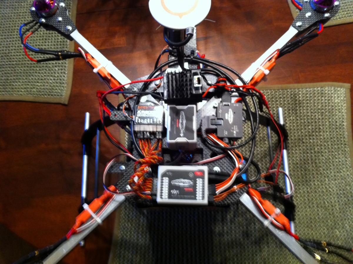

@Dave, few quick questions about installing the wkm in/on the flame wheel frame if you don't mind.
1. any thoughts on component layout on the two decks - can all the wkm components sit in the lower space (lipo up top) - or is there an issue with being so close to the power board?
2. i assume it's double sided tape to keep everything in place - 1mm thick foam tape ok or something without padding?
3. did you wire your led's to the powerboard - so they're on as soon as you plug in the lipo?
cheers

Dave you can mount the battery in the center and put the electronics on the top.

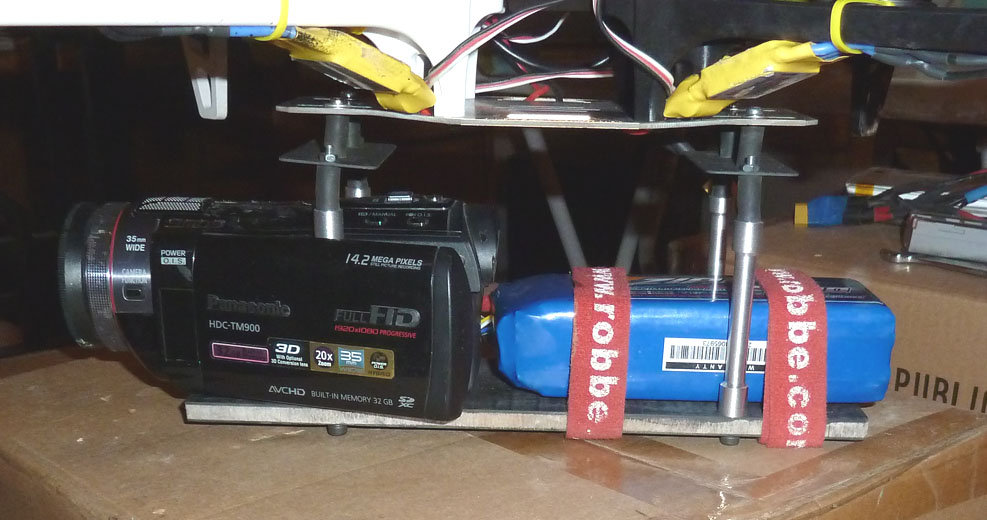

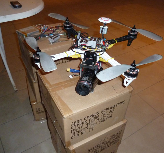

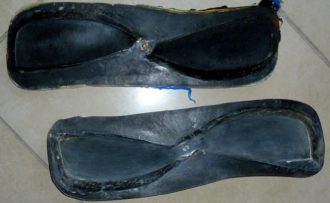

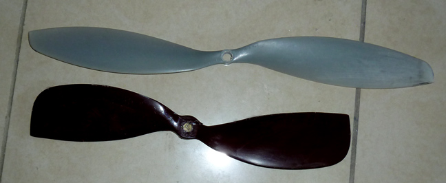

The props are 11x4 autoclaved in carbon prepreg. Shown alongside an 14x4.7 APC for comparison. They actually weigh only 14 grams each The motors are TM4008 with 30 amp TM ESC. The combination is designed around fast response. Performance is also blistering. This is overpowered for normal flying stuff. Shown here with a Panasonic TM-HDC900 and a 5800 mAh. battery. Cutting down a 14x4,7 to 10x5 or 11x5 is also not a bad prop.

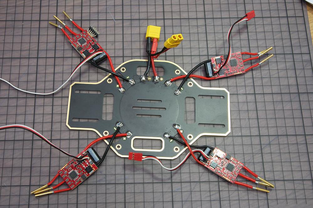

Just started putting my F460 frame together..
First impressions.....
plingboot
solder pads go on the inside.
having sat here placing components in various combinations, it's pretty obvious that the wkm will work with the flamewheel, but it's really designed for the Naza.
if dji start selling spares, i'd have another to deck just to give myself a bit of breathing room.
it'd also be nice to have some spare pads on the distro board, at the moment the wkm install looks to require a split lead between the lipo and the distro board to power the pmu/components - more pads would mean this wasnt required.
great frame and nice size though.
