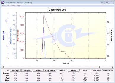

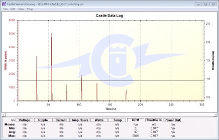

I have old version WKM MC, purchased December 2011, hardware ID 50114880
ESC Castle Creations Phoenix ICE50, fw4.01 for Multi rotors, outrunner mode. ESC mounted under motors.
Motors AXI 2814/22
Voltage 4S
Data Radio 2,4GHz Single Waypoint
Transmitter: Spektrum DX-18
Receiver: Spektrum AR9020 DSMX + X-Plus Expansion (for 18channel use)
Spectrum telemetry module installed
Configuration:
Octocopter flat, "I"
Cut Off Type: Intelligent
Enhanced fail safe methods: Alt Go-H (30m), Go-Home switch enabled
Intelligent Orientation Control: Control 3
During initial configuration of 5.12 I experienced CFG-ERR indication in the Assistant SW (1.30), but after having gone through all the tabs and clicked "Write", and re-cycled the power - then only normal indications.
ISSUE: Motors 7 & 8 twitches - very short (probably less 1/10 second) periodical power bursts, see the videos linked.
I did not attempt to fly with 5.12.
FW 5.08 worked fine, no anomalies.
Two videos on Youtube. The periodical beeps has got nothing to do with the issue, it is just the CC ESC "power on" beeps - they are normal.
Images from CC ESC internal data log, ESC 7, RPM plots at 2 and 10 samples/second:
View attachment 5236View attachment 5237
The sample rate is too slow to capture the pwm glitches from MC, but you can see the resulting RPM movements.
/ Tomas

So now the fix is released - 5.12a Beta
And DJI added a red text note about end users feeback. Unfortunately it does not clearly state that if you are using traditional receiver on an octa then you SHOULD use 5.12a Beta instead of 5.12. On has to read the change history document to figure that out, I hope people do that...
The release history states:
What is changed (refers to 5.12):
- Fix the M7 and M8 spinning up problem of octocopter with traditional receiver.
- Improve the gimbal control performance by reducing the gimbal irregular shaking, so as to make gimbal movement smoother.
So it might be worth noticing that while the spin up problem has been recognized and fixed, they do not mention the in-air shut-down or flip problems that some users experienced. I suppose the latter is not yet fully investigated and conclusions remains to be made. This leaves me slightly uneasy...
