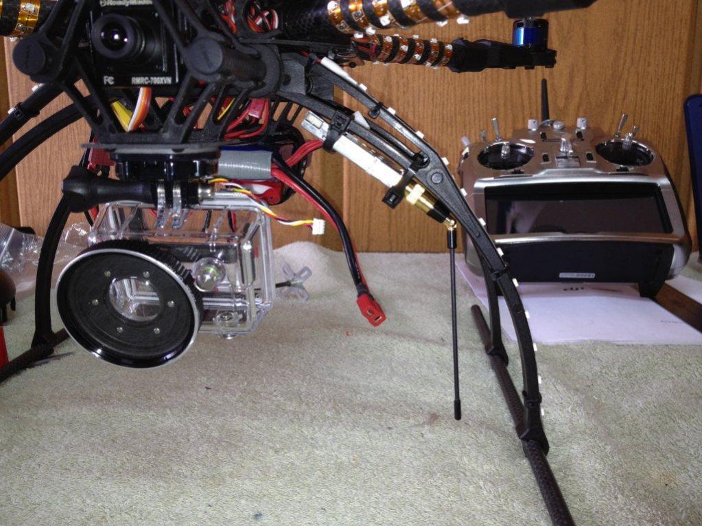

You should be ok with that positioning. I was mainly worried that you had the rx up front just above the vtx.
I set mine up so I had the RC rx up front (with a satellite) , then the vtx in the back with the GPS centered and up above all of it.
rwilabee
Here is what I finally ended up with to get the vtx antenna further away from the gopro so it wouldn't interfer with the signal to the ground.
Rich
