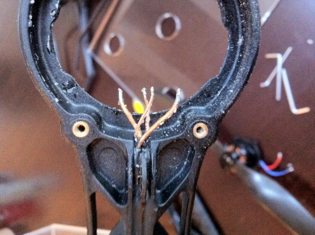

just taking out the ESCs and hoping for replacements these days to get the bird back up in the air. I am a little worried though how close together these PPM and Power leads are considering that the Arms are not really vibes free. Are you guys isolating them in some way ?
I don't like silicon or liquid tape when it comes to small areas its really hard to tell how thick the layers are etc.
Boris

hmm don't get it were are they isolated ? They are blank wires coming out of the arm being crossed over each other etc. And its surely no problem to solder them on so they don't touch each other but it dosent give me a good feeling to have blank non isolated wires close or less than a couple mm to each other ?
Boris

I made the same mistake in another thread. Look closer. They are insulated. the tips aren't just silver from solder that's the actual wire. The copper color is a coating.

My multimeter dosent show a sign of life so I can't test continuity. Does one of you know what is what from this side ? Plus GND PPM and I Guess GND again View attachment 5064
Boris
