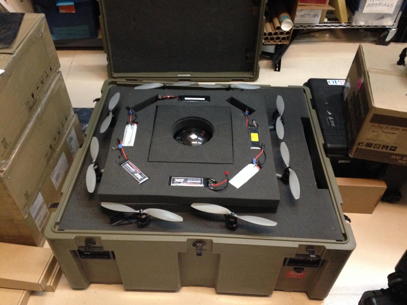

OK guys it’s confined.. I have the SkyHero 700mm set up with a Naza M Ver 1 on Firmware 4.0 and on stock settings it was almost flawless (Not as good as the SuperX, but really nice)
None of the weird twitches or oscillations it performed as I expected.
I am 100% convinced that the firmware that is being used on the Naza Lite is old Naza firmware when it did not like larger props or larger airframes.
SO now the rig is happy, I’m happy and i’m going to build a 450mm night flyer with the Lite....
Also.. this sky hero rig (for a non AV fun potentially FPV rig) is FUN!!!!)
