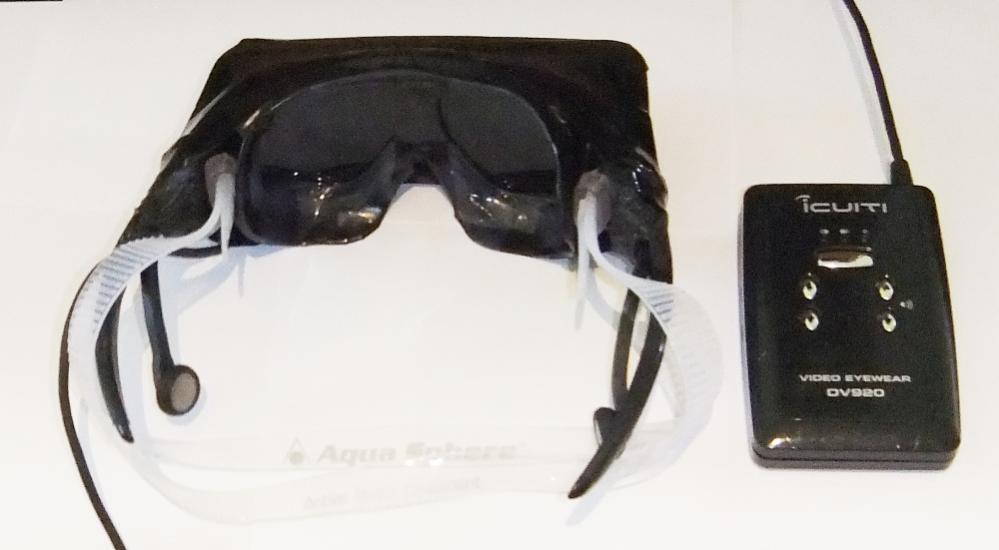

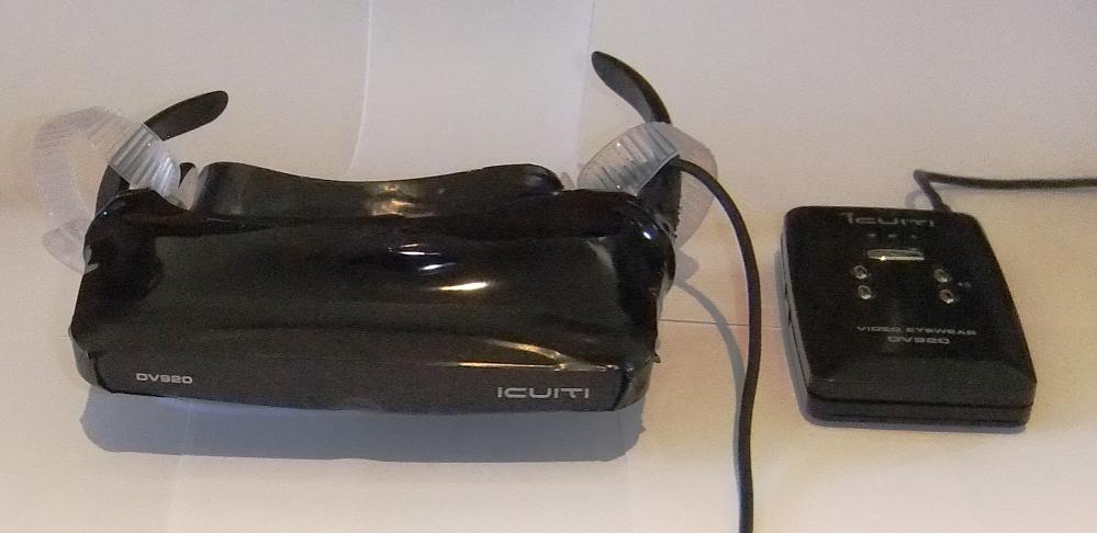

Changing to a separate battery got rid of the noise problem for me, without having to resort to doing much else. Although range is not that big a deal for this setup, I think I would get fewer dropouts with better antennas. I'm using a 3dB whip on the F450 and an 8dB patch on the receiver end. If I get serious about this, I'll probably at least upgrade to some cloverleaf antennas, and maybe a diversity Rx setup. I'd also like to do something about replacing my goggles. I took a pair of video "glasses" and mounted them in a hacked-up set of swim goggles, and then enclosed the whole assembly in black shrink-wrap. It works quite well, but is not all that comfortable to wear. :) Anyway, CNC has a pretty good combo setup with Flycam 5.8GHz integrated set of goggles, that looks awfully tempting. :) I need to add an OSD widget as well.
