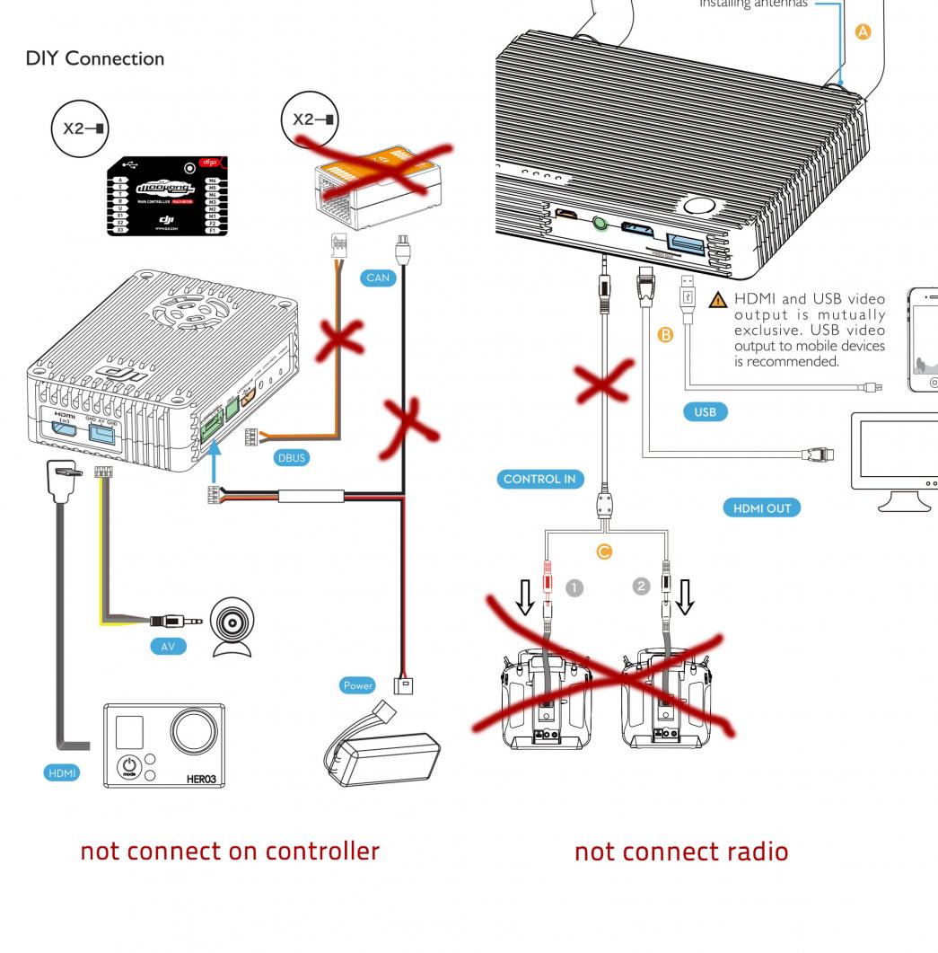

Working with production of aerial video, use products dji from the beginning, just do not use the gimbals of dji, my equipment is 100% customized for market issues today I'm flying with the Black Magcis 4K and an analog dowlink.
the doubt is whether I can use the DJI without Lightbridge connected to A2 or Naza? Why is my gimbal has no connection with the frame.
Another doubt is whether it is mandatory to connect my Futaba radio in DJI Lightbridge? I can only use the DJI silples Lightbridge with a digital video transmitter?
My setup would only Black Magics SDI to HDMI coverter for DJI Lightbridge and recepitor connected via HDMI on a monitor. Is this possible?
image attached

I have a 4K, I am getting the white screen on the ground station. I take the SDI out of the camera convert it to HDMI (this works as I can plug monitor in dorectly and I get full picture. If I plug my playstation hdmi out into the airside I get transmission fine to the ground station. What do you use for converting the 4K SDI to hdmi for transmission. I suspect I am a victim of hdmi protocol versioning here. Any help anyone ?
Thanks in advance.
