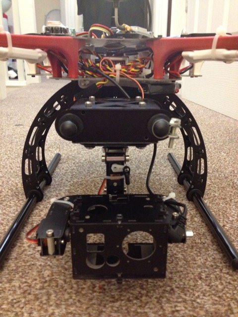

Hey kroner, I'm not sure about the frequency of the servos either I've not been able to find any detailed information on them. The gimbal does seem balanced, I will stick a pic of it up. I will give the lipos a full balanced charge and see how they look. View attachment 9740

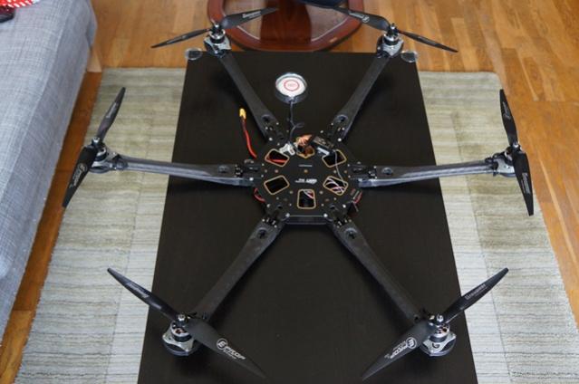

I have also a heavy F550 with the same landing gear and gimbal plus FPV equipment. My experience is that it does not fly well on 3S lipos and the 10" Graupner props. It was running at +80% throttle just to hover, with very little room for error in case you need some extra power to save your hexa. It flies much better on 4S, more power to spare.
