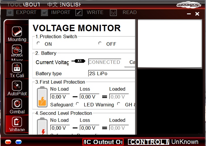

With Windows 7 my DJI assistant was runing with XP Mode but this future disappearsView attachment 8798 with Windows 8.
The windows of the assistant is not complete as you can see on my screen shoot.
How do you manage this problem?

I seem to remember in 7 there is something like use Windows default scaling in display control panel, I think.
I had the same thing happen in W7 using Bootcamp, but once I checked that box or something like it the Naza SW showed up perfectly.

Try
Control Panel - Appearance and Personalization - Display
and select Smaller - 100%(default)
Often high resolution laptop screens are set to Medium(125%)
Hope this helps
Andy
are you able to change your font size to small? The text is too big in the box, and the box has a set width x height......

When I get home from work later tonight, I will look at my settings, I don't think I made any changes to anything, just ran it with compatibility mode on.
I think, on the desktop icon, if you right click it, hit properties and select compatibility mode, you will see the options, I think mine just shows windows XP. Nothing else is checked.

It's ok now. I have found that I have to change the text dimenssion into the screen resolution windows. On now all is good with the DJI assistant.
Thanks to all.
